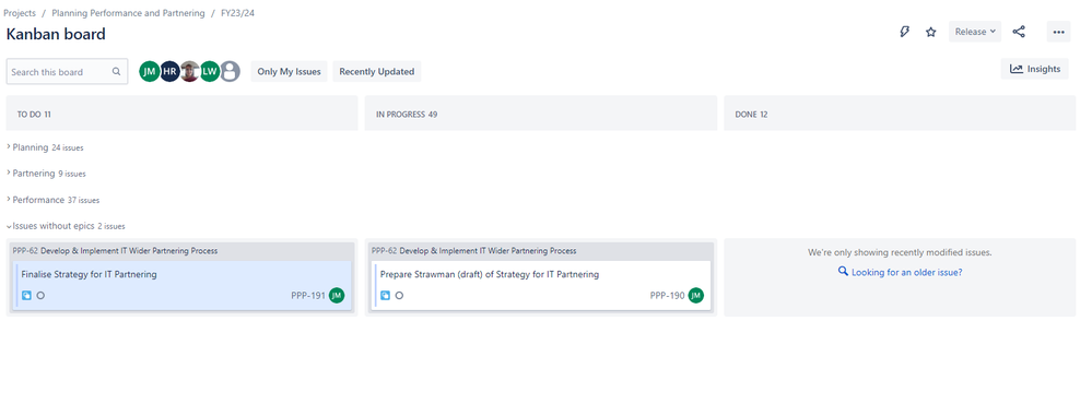

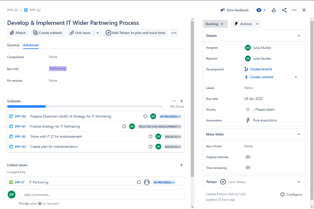

I have created a task and linked to one of my EPICS.  I then created 4 subtasks on the Task.  2 of these have successfully showing under the EPIC however 2 are showing as no EPIC.
Below is the issue which has been linked to an EPIC.  However on my Kanban board Sub Tasks 190 and 191 are showing as not Linked to EPIC
Issue linked to Epic.PNG Any thoughts?

I've managed to reproduce your issue, and this happens because your two subtasks (which appear to have no epic) are moved to another status while your Epic stayed in the backlog. Thus, no epic is visible on the kanban board. As soon as you move your epic on the kanban board (e.g. selected for dev) then these subtasks will move to a dedicated swimlane.
