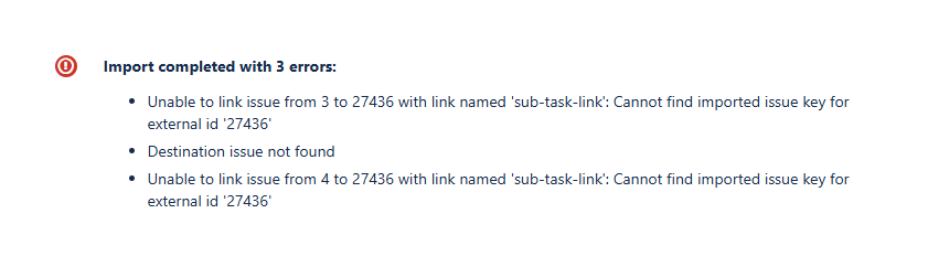

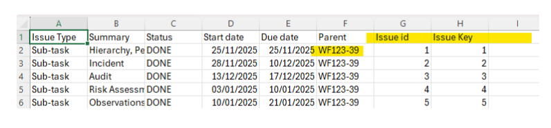

I have been struggling to upload a csv file to create subtasks and link them to existing issues.
I have tried every single possible combination and I have read through the documentation several time, I just don't get what I am doing wrong.
Attached you see the format I have used and I have been trying by mapping and not mapping the issue key but I always get the same error.combination 1.pngcombination 2.pngerror.png
The sub-tasks are created but not linked.
Hope someone can help!

Looking at your import csv, I think that you should include the parent issues (it appears that you have sub-tasks only)
The thing is: during the import process, Jira uses new work item ID's for newly created work items to prevent making work items with the same key. This means that your IssueID column is bypassed during this process.
The issueID's columns in your CSV are only used to couple the sub-tasks to new parents (whatever ID they might have gotten by the import process. Yes, Jira is that smart )
It means that an import process needs both parents and children, in that order, as stated before.
Kind regards,
Dick

I was able to create the subtask and link them to existing tasks using the below configuration in the end:
I did not map the issue key during the import, just the parent and the issue id.
this is the saved configuration that worked:

At one point, I also thought that I needed to list the task to be able to add them to the subtask but the trick was adding the issue id and issue key with random numeration and it worked.

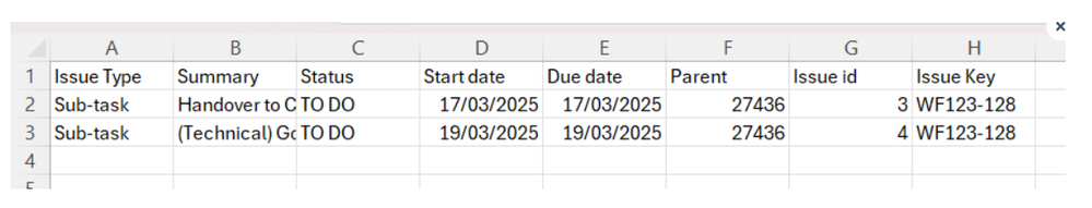

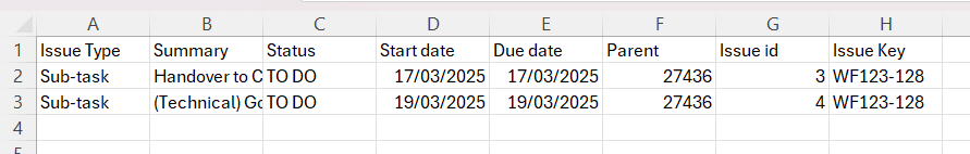

You import sheet needs correction I think.
Remove column F & G. Rename Column H as Parent. Assuming you want the new subtasks to be created under WF123-128 (should be standard issuetype other than Epic).
Marta Perez
April 14, 2025
Hello,
If you refer to the below attempt:
with your suggestion it works for the normal parent-child relationship and by mapping parent to parent link during the import, however it does not work for task-subtask.

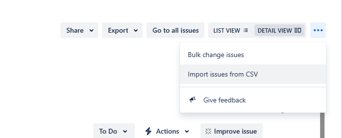

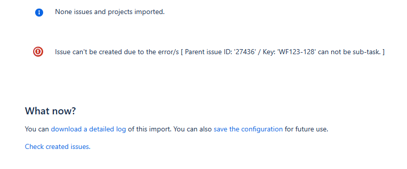

When I try the to perform the upload from the issue view, I get this error: issue view.pngkey cannot be a subtask.png
Do I need to rearrange the order of the columns?
