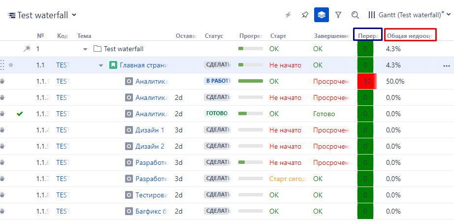

Thank you Dmitrii.
It worked, but only partially though. With "original" formula the upper hierarchy levels summed up the values, while with "enhanced" version it does not.
Please see attached screenshot where blue marks "enhanced" version, and red marks "original" one.
Hi Ivan,
The formula calculates the values for all tasks, but because of how ROUND function was configured in my example, 4.3 turned to 0.
Here the formula rounds value to the 1st decimal place:
ABS(ROUND(Overspending / Original_Cost,1)*100):
Customizing the formula to round value, let's say, to the 4th decimal place should provide the results you need:
ABS(ROUND(Overspending / Original_Cost, 4)*100):
