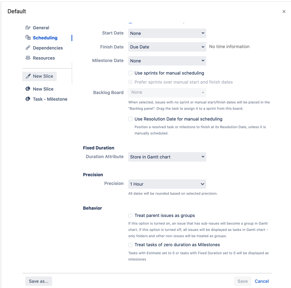

1. You can achieve this by doing the following:
- unselect the 'Treat tasks of zero duration as Milestones' option in Gantt chart's configuration(it's in the Scheduling tab).
- Click the New Slice button on the left in the configuration, select JQL at the top and define the scope of issues to which a new set of rules will be applied: for example, originalestimate is empty and type=bug
- click Add Section at the top, select Behavior | Milestone, save and close the settings. As a result, only bugs that have no Original Estimate defined will be treated as Milestones.
You can find more details about the Slice-based configurations in our wiki here: https://wiki.almworks.com/display/gantt/Slice-based+Configurations
2. Can you please clarify - do you mean Epics have Start & Finish dates defined in fields and you can't see them on the chart or you mean to ensure that Epics have both values on creation, or you mean something else? If both dates are there and you don't see them on the chart, this is possibly because of the enabled 'Treat parent issues as groups' option at the bottom of the Scheduling tab of the chart's configuration. Unselecting this option might help.

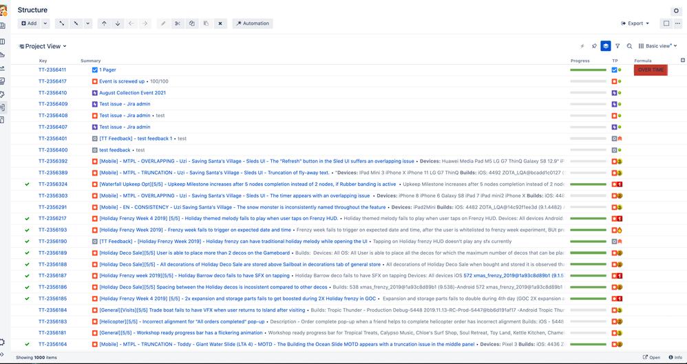

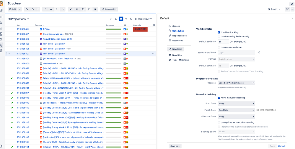

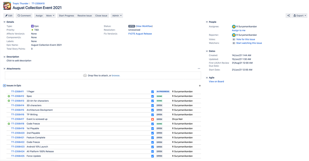

Anusha Ramesh
June 28, 2021
Hi @Stepan Kholodov _ALM Works_ ,
PFA and help me to
1. Display total count of open tickets (Task & Bugs) under EPIC - (In Structure)
2. Display total count of open epics under fix version - (In Structure)
3. "Start date" and "end date" field for Epic Creation
Screenshot 2021-06-28 at 1.55.26 PM.pngScreenshot 2021-06-28 at 1.57.01 PM.pngScreenshot 2021-06-28 at 1.58.38 PM.pngScreenshot 2021-06-28 at 1.59.10 PM.png
Atlassian Partner
June 28, 2021
Thank you for the screenshots. Can you please also:
1. Add the Due Date column to the structure;
2. Open the chart in the right panel;
3. Take the screenshot of both the structure and the chart so we could see how Epics are shown on the chart as well.
P.S. Please note that if you have any sensitive information on the screenshots, it will be available for anybody to see here. We recommend to continue the discussion at our support portal where we can properly and privately help you with this. To submit the request, please either create it at support.almworks.com or send a direct email to support@almworks.com
