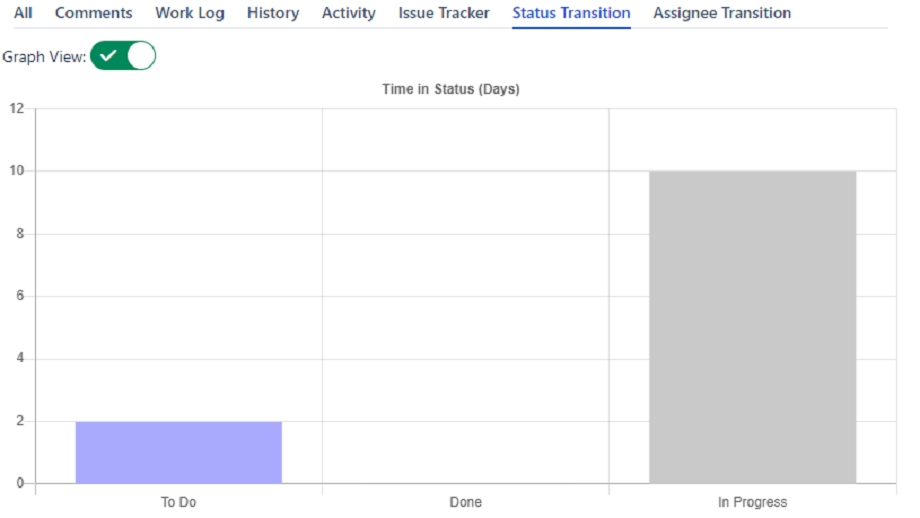

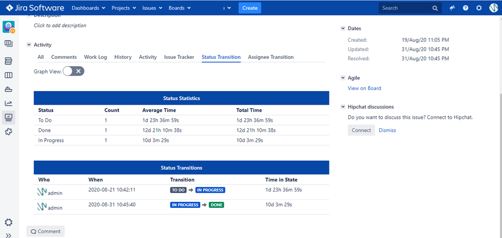

We have built an addon specifically for this need, as there is no easy way to extract this information out of the box.
You can try Issue Tracker for Jira
It will provide you below charts on the issue screen itself.
Thanks
