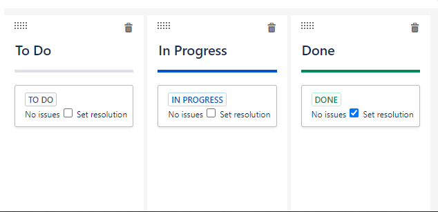

Please confirm when you create Story Issue type whether you have the strike on the board when you have it in active sprints.
And when does it strike when you move through the boards.
So when it strikes, check the post-function transition of that workflow.
Please confirm whether you can see the Column option in board settings, If it is, uncheck the Set resolution option for other statuses
Now If you have the workflow with global transition for all the status, once the status is moved to done state, we have to take care of post-function to clear the resolution when it moves to other status.
