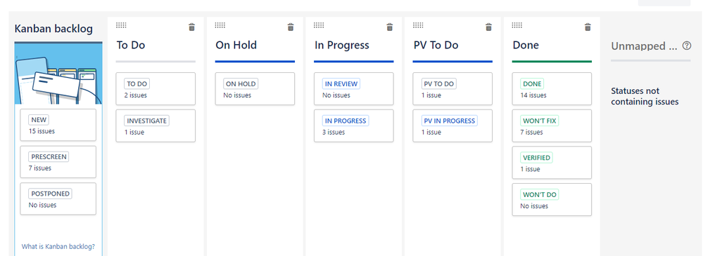

PV To Do is grey & this is intent, this status is also used in a different QA Kanban board. This PV To DO state is a different one from status To Do:
