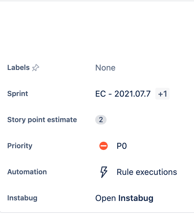

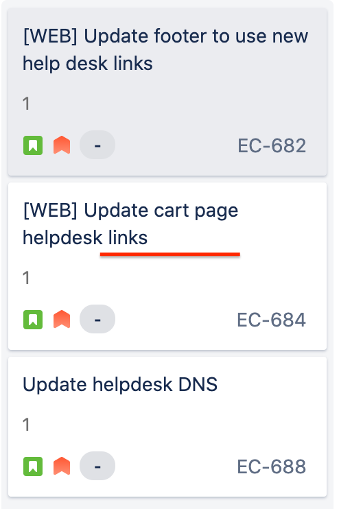

We can not find how to get Story Points to show up in pill/cell in our Sprint boards. The following image shows what I am talking about. The point displays above the issueType icon, but not in the pill between the priority icon and the ticket number.

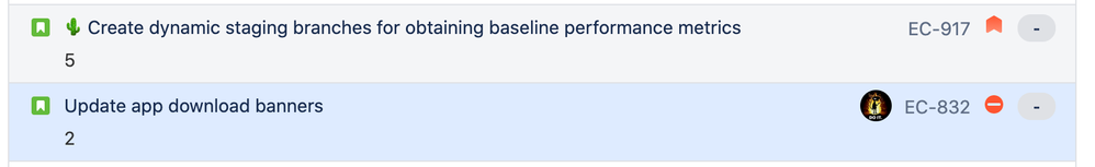

These two images show that we are recording it in sidebar of the ticket, and also how it displays in the Backlog view.

this is a company-managed project right? You can determine that by looking at the project, on the bottom left it is stated.
Those project use "Story Point" as a custom field - however, team-managed projects use "Story point estimate" as Custom Field.
I seem to see that you use the field "Story point estimation" to put Story Points into - later you refer to a different custom field (Story Points).
Probably this is the simple cause and you would be needing to use field "Story Points".

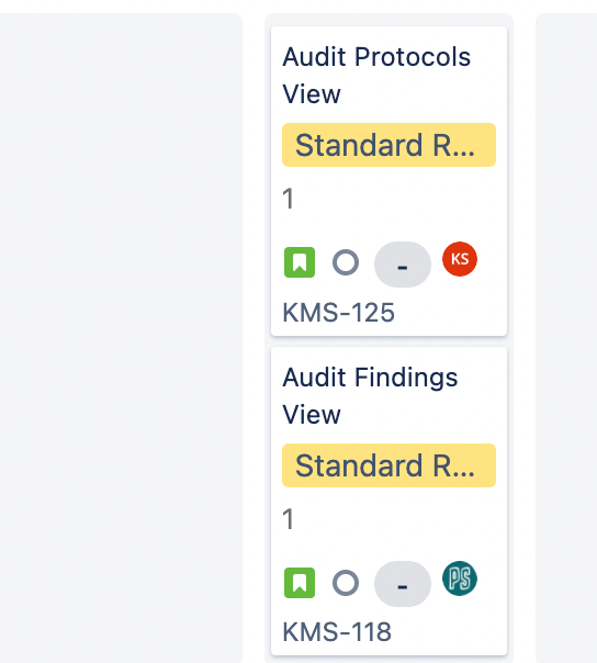

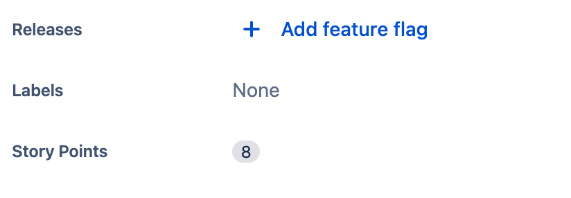

I am having the same issue. This is a company managed project. What setting do I need to change and where?

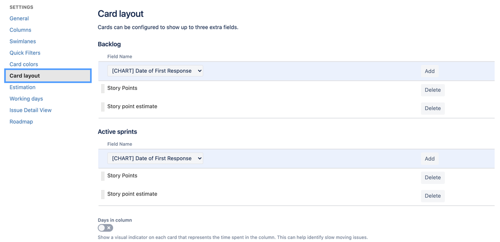

You can populate this in board setting -->Card Layout and select Story Point estimation .
It should work .

Thanks Shruti. I believe  we have it set up correctly but still not showing up.

I believe you have not given Story point .I can see that Story Point estimation is given .
In order to show the Story Point in between Priorty and ticket num ,add story point value .

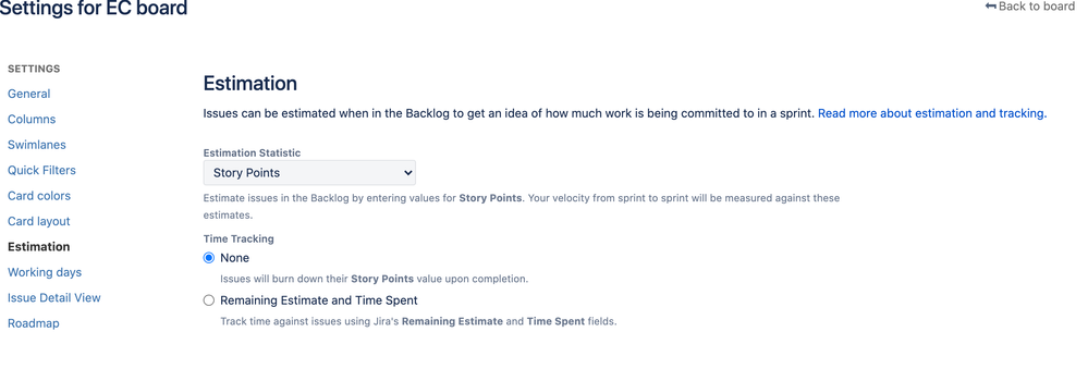

Andrew Custer
July 20, 2021
Thanks for your response Bastian. We already have it set to Story Points. That's what is confusing us.
