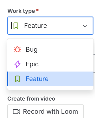

Hi Guys, I cant see Story issue type, only epic, tak and bug, please support me to display Story as Work type

Thanks @Trudy P Claspill you mean with standard plan we can see only 2 levels, epic and task, no story? There are 3 though 1, 0 and -1 as levels

Hello @Jira user
Have you checked your work type scheme if you are using company-managed Jira space?
Make sure that Story work type is there. If it isn't, you would need to add it to your scheme. Before you do that, check if your work type scheme is being shared with any other spaces.

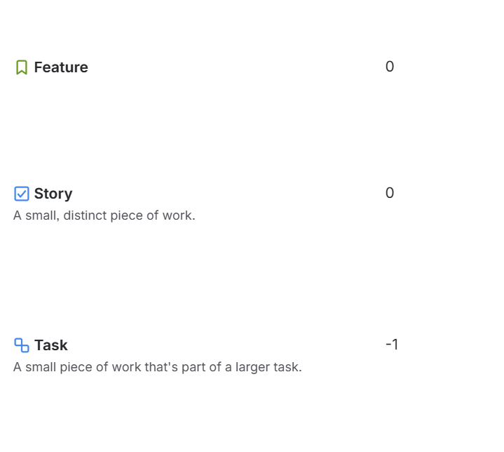

It has to do with the hierarchy level, I added Feature, can I add another level because so far there is only 1 0 and -1?
I added a Story and I want to have Feature as parent

I have deleted Story as it is same level as Feature, so Story disappeared froö the list and 'Task' is not showing at all on the list, is it normal?
