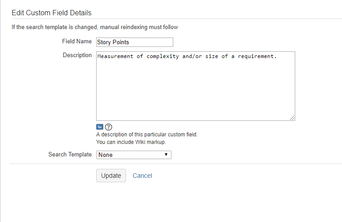

I received the following information from Atlassian's support team, and it solved the matter.
"After some time investigating this issue, I found out that the root cause is that the field was edited and a configuration was changed.
In https://dcimarketing.atlassian.net/secure/admin/EditCustomField!default.jspa?id=10004, the Search Template settings were changed from Number searcher to None."
This came from Gabriel Müller, Atlassian Cloud Support.
Thanks again Gabriel! :-)

I received an answer too.
I had a look on your instance and found that the Story Points field configuration was updated by one of your users. It is specifically for the Search Template which was changed to None; causing the Story Points shown as dash.
I have changed it back to the correct value and you should be able to see the Story Points again.

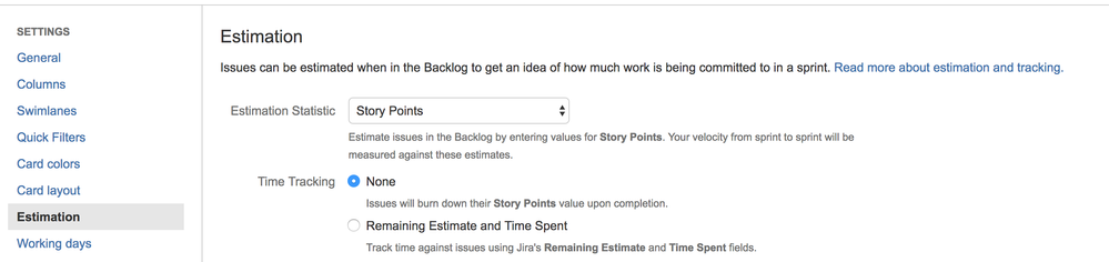

January 17, 2018
Hi Fred,
Did you check the board configuration?
Check if you have the following:
Fred Bidel
January 18, 2018
I checked both, and they are set up exactly as you suggested.  I added a screenshot of how the Story Point fields look like in our Backlog.
