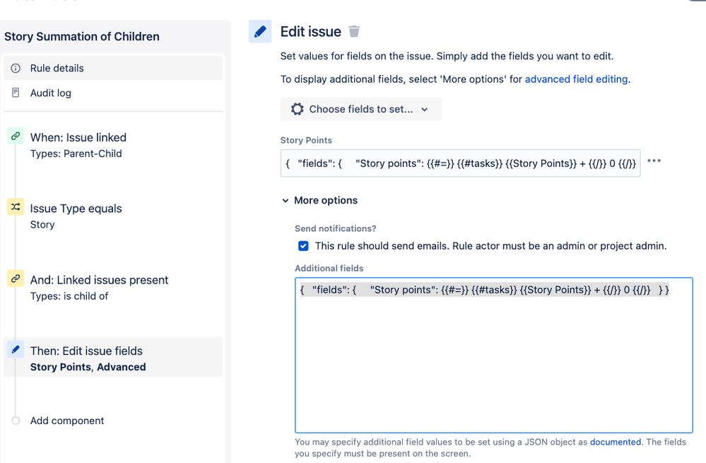

I've read countless articles on this and outside of summing Story Points of Sub-tasks, I cannot get this to work for Tasks.
Does anyone have code that sums Story Points from a Task to it's parent Story?  or just code that sums Story Points from children to its Parent?
These do not work:
  • {"fields": {"Story Points": {{#=}} {{#subtasks}} {{Story Points}} + {{/}} 0 {{/}} }}
  • {{lookupIssues.Story Points.sum}}
  • {{issues.tasks.Story Points.sum}}
    I've tried various combinations of actions and triggers. Screenshot 2023-03-19 at 7.21.22 PM.png

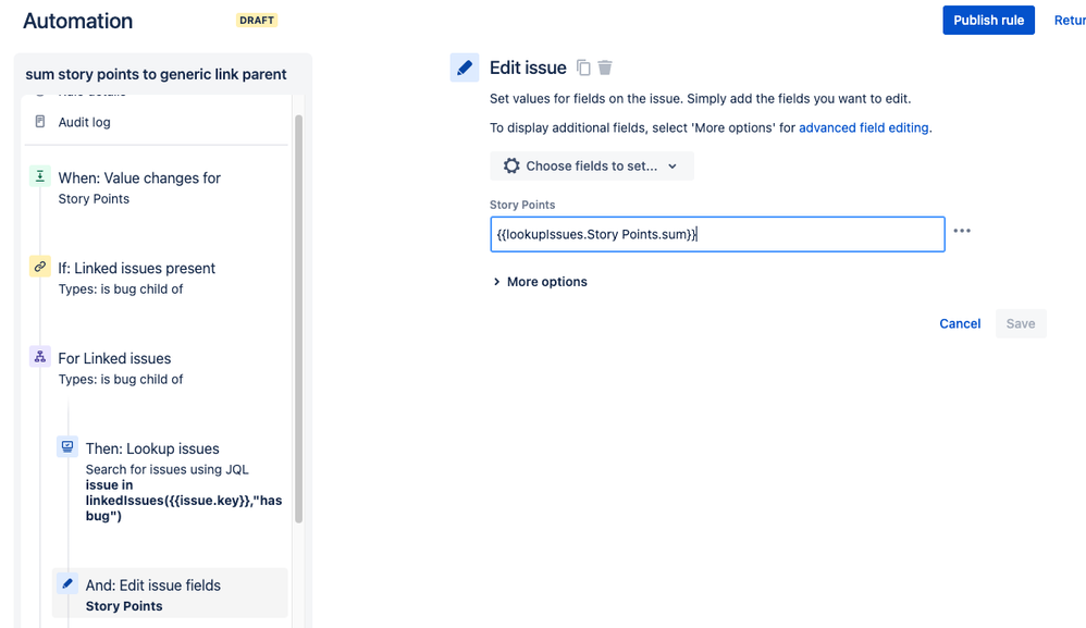

Here is a rule for summing up story points through a generic link relationship. In my case the link relationship is Story "has bug" Bug. Stated in the reverse that would be Bug "is child bug of" Story , which is similar to your generic parent/child link.
This rule is triggered when the Story Points on the child Bug is changed.
You might also want rules that recalculate the story point sum if a Task is newly linked to a Story, and if a link between a Task and Story is removed.

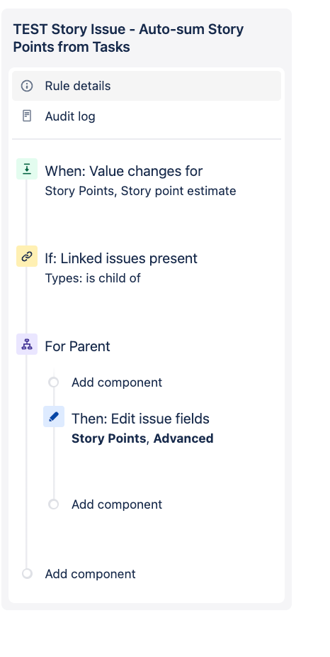

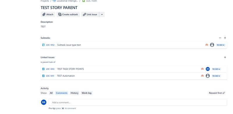

Stumbled upon this forum looking for a similar answer. I used a similar automation rule as @Jay R and tried to test to see if the story points roll up. @Trudy P Claspill here's a screen image of some test tasks and a test story while working on this. Also added a sub-task to try to replicate the same automation for that issue type.

Is your goal to take story points from both the linked issues and the subtasks and sum those to create a story point value for the "parent" issue?
Can the linked issues under "is parent task of" have more than one "parent" link?

Thanks for the warm welcome! These issues are on a company managed project. My primary goal is to take story points from the linked issues-- I'm using the Task issue type and linking it to a parent story-- and was trying to sum each task up for a total for the Parent story. I took a swing at trying it with subtasks as well, but getting the roll up from that issue type isn't my highest priority as our team primarily uses the Task issue type
