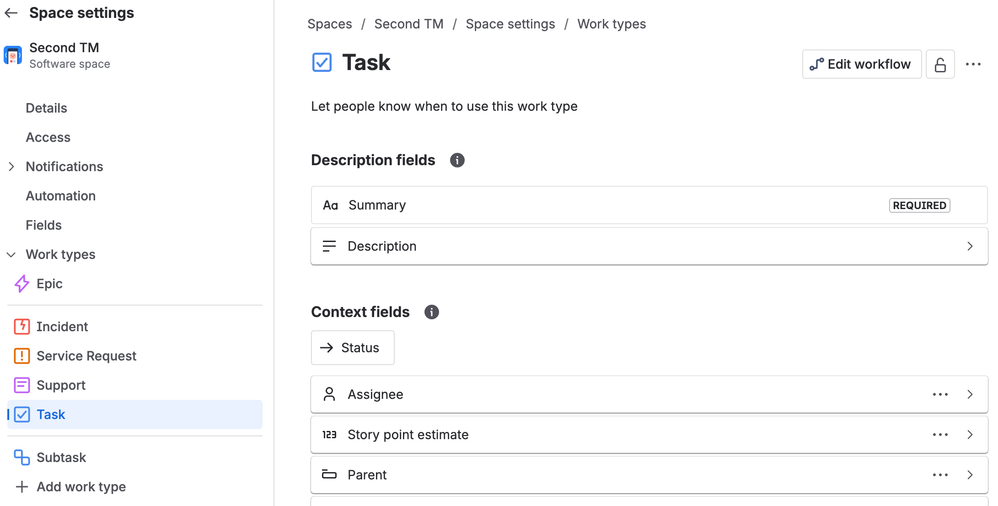

PS: try removing the Story point estimate field from the Story work type configuration, saving, then adding it back again to the Context fields section. And check how behave then.

Thank you very much, this solution has worked for me. It is a Jira bug. Possibly related to the fact that I have done CSV import of the items to create space backlog.
In a nutshell, remove Story Points estimate field from the space then add it back to the space and assign to Work items you want and it is showing when editing actual work.
