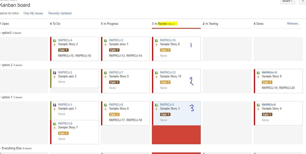

We are tring to understand the behaviour of KANBAN board of JIRA.
We have one use case to restrict addition of issue in kanban column if it exists the max value means if the max number of issue allowd in kanban board cloumn is 2 than user will not be able to add the issue more than 2.
Currently user is able to add the issue more than allowed max value.
Now color of cloumn is changing based on max and min value but we want to restrict the addition of issue.
Is there any to to restrict it from workflow transition.

Regarding your question, it has been awhile since I have used constraints on Kanban and doing a quick read of the documentation tells me that these are 'soft' constraints. That is, they do not prevent but rather only alert. So it requires manual intervention. I do not know of anyway to prevent.

correct. there may be some plugin or you could do by writing some code around this feature. However, I suggest that if you are using a board you should have an owner and their job is to monitor. In most use cases you don't want to prevent work from progressing but you want to be aware of potential overloading.
