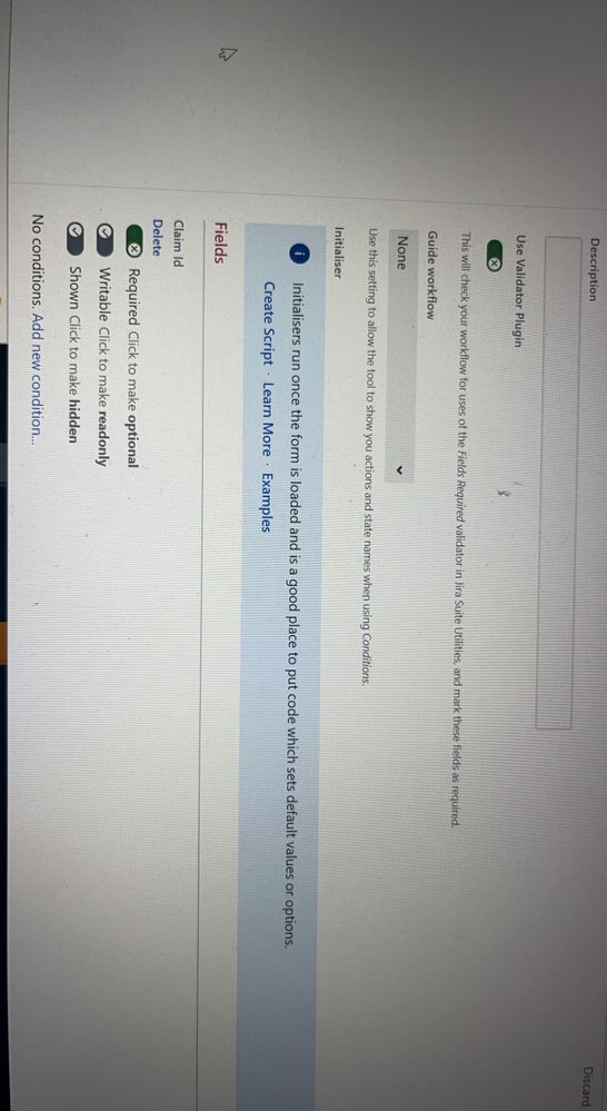

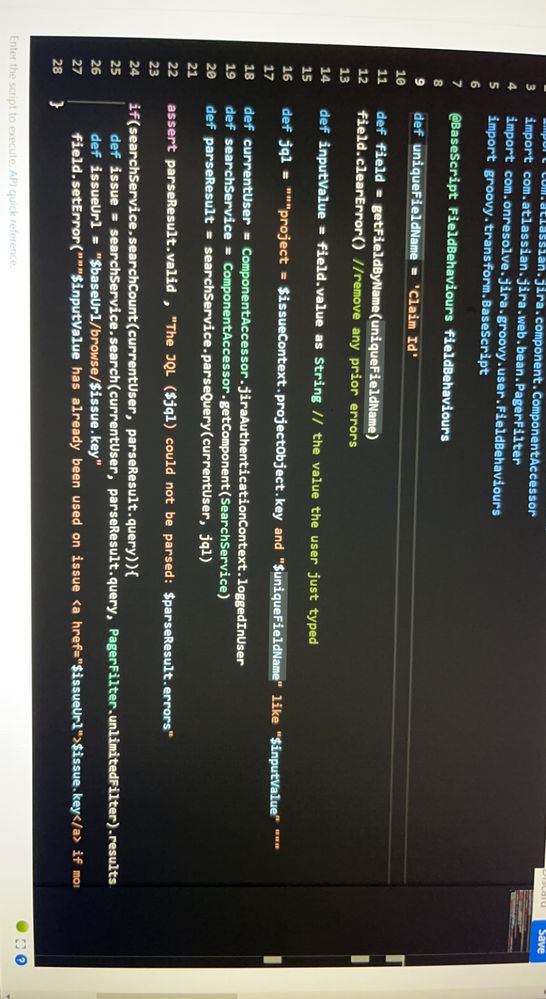

I have placed the first code you gave in the behaviour and added the custom field against it but it is still allowing me to enter duplicate data when creating issue for that field, any possible reason ?
Thanks again
PD Sheehan
January 10, 2023
Can you share a screenshot of the behaviour configuration page?

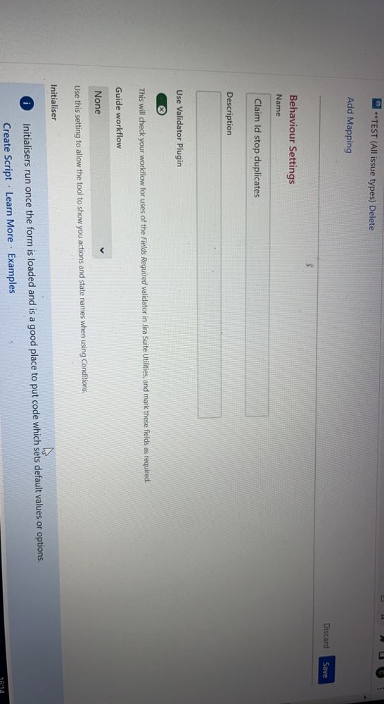

Caoimhin Caldwell
January 10, 2023
Screenshots added
Caoimhin Caldwell
January 10, 2023
Caoimhin Caldwell
January 10, 2023
920271C2-EA79-4A71-BA3A-C21534D3BCDA.jpeg60243DD1-5DCB-48DE-B969-594B257E4161.jpegDE8955CF-A88C-4FF6-AC95-316264247AB5.jpeg
PD Sheehan
January 10, 2023
Can you review the atlassian-jira.log file for errors at the time that you attempted to update the Claim ID field?

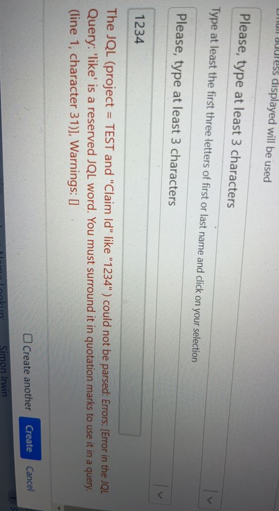

Caoimhin Caldwell
January 10, 2023
Getting this error on the create screen 1842931B-92DC-49ED-90EA-C7FD147736F1.jpeg
PD Sheehan
January 10, 2023
Ah!
Sorry, that was my mistake. I've been working with Assets AQL too much lately.
Let's try this:

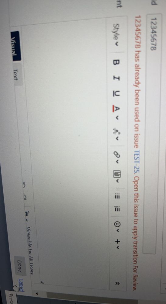

Caoimhin Caldwell
January 10, 2023
Amazing ! That’s working , final question , any good resources/websites to share to get to this level of groovy scripting ? Really impressive , thanks again Peter !
