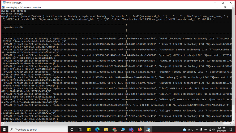

I did run that sql query in MYSQL database(see attachment).
Also, after installing the app, there is no need to perform any step to fix the issue as mentioned in the description of the app (Check this link: https://marketplace.atlassian.com/apps/1221117/cloud-compatibility-for-jira?hosting=server&tab=overview )
Pls let me know if I am missing anything.

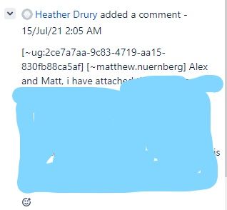

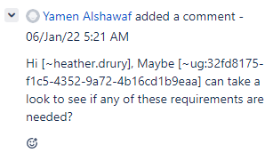

After running the query in the DB, it has changed some of the accountIDs to the username in comments but not all of them (Attaching the screenshots , so you can see it).
Pls let me know what i am missing here.
Thanks for all your help!

@Shreesh Narayan Singh  looks like it has updated few of the usernames I guess and some of the usernames are not updated.
Can you just check that by taking one AccountId and see does that account name is part of user in the directory ? Like correlation type. After try running SQL query once again.
