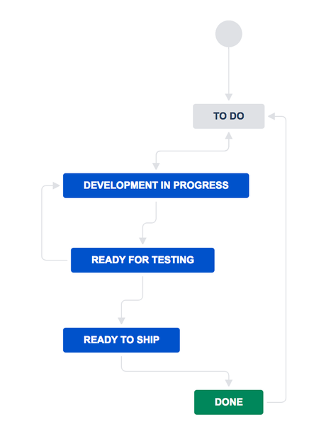

We created a simple workflow as below:
The problem is when the issue in "Development in progress" status, then clicking on "Ready for testing" doesn't change the status to "Ready for testing" at all (but action buttons changed to Testing Passed and Testing Failed".

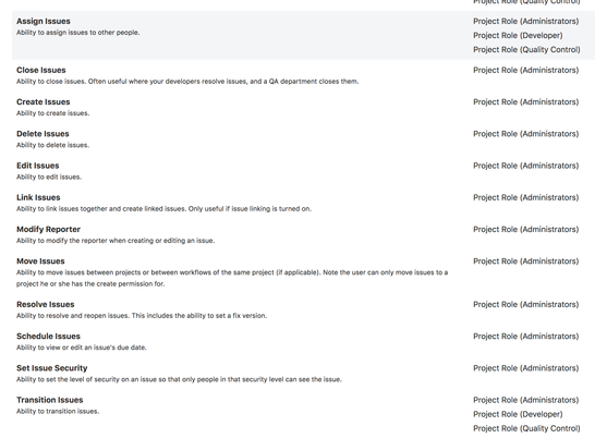

Thanks for the info, I've checked permission before and sure I've transition, edit, assign issue permission, please find below: (my account is mapped to "Administrators" role)

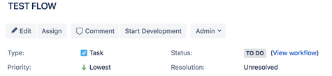

My issue is, for example I have an issue in "Todo" status:
1. Go into issue, saw status "TO DO", with action button "Start Development"

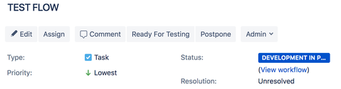

2. Click on "Start Development" will change status to "Development In Progress", action button become "Ready for Testing", which is correct:

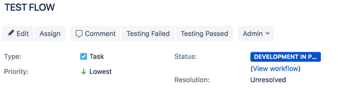

3. Click on "Ready For Testing" button will change actions button, but not status:
This issue persist until the last step, "Migrated" to change status to "Done" <= this works.

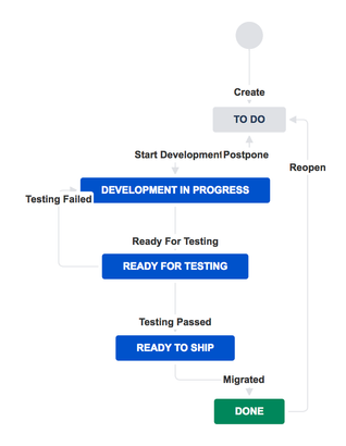

That's not the case too, I slightly dragged them off the center line and turn off the labels, please find below:

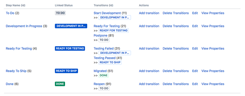

This is the flow as text:
Screen Shot 2018-12-19 at 1.59.02 PM.pngThanks for your help and support, any additional information I can provide, please let me know.
