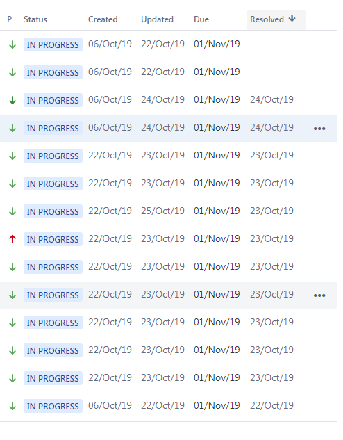

Anyone can help me to fix this case. The status of ticket is In Progress but Resolution is Done, also I have date to done as image as below. How can I remove the Resolve date in this case and remove Resolution (Done).
Thanks

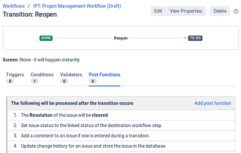

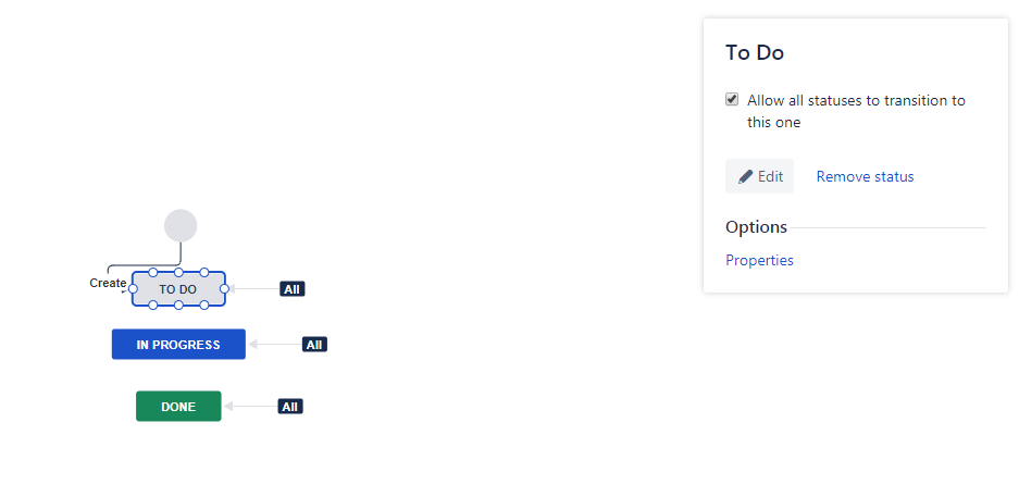

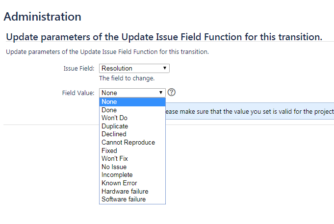

Make sure that the global transitions to the To Do and the In Progress statuses have an Update Issue Field post function that sets the resolution field to None
This is how it should look like (in this case for a non global transition):

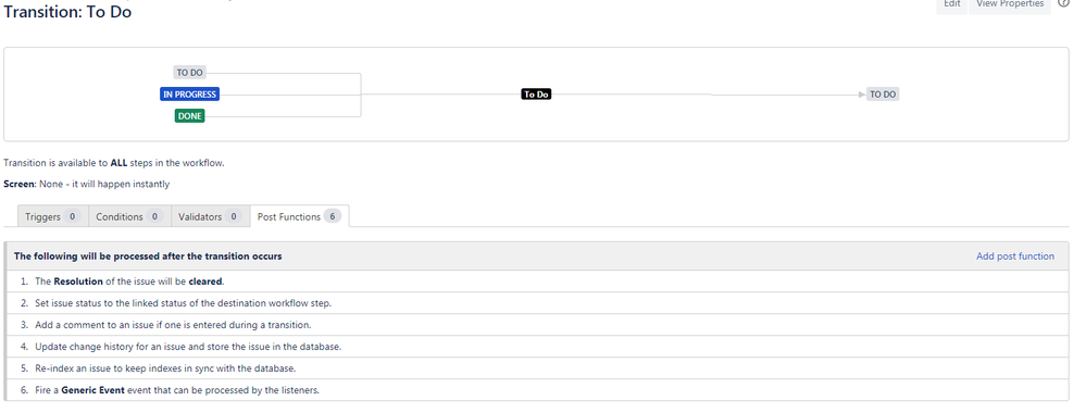

tran.pngChanged, but the issue is still happen the same. :(
Tan Phan
October 25, 2019
Updated. Change the status in ticket to In Progress it will be applied imediately. Fixed.

Hi @Haran Kumar , just do it but don't have Unresolved option to choose. How can I do?resolution.png
Tan Phan
October 25, 2019
Thanks, Fixed

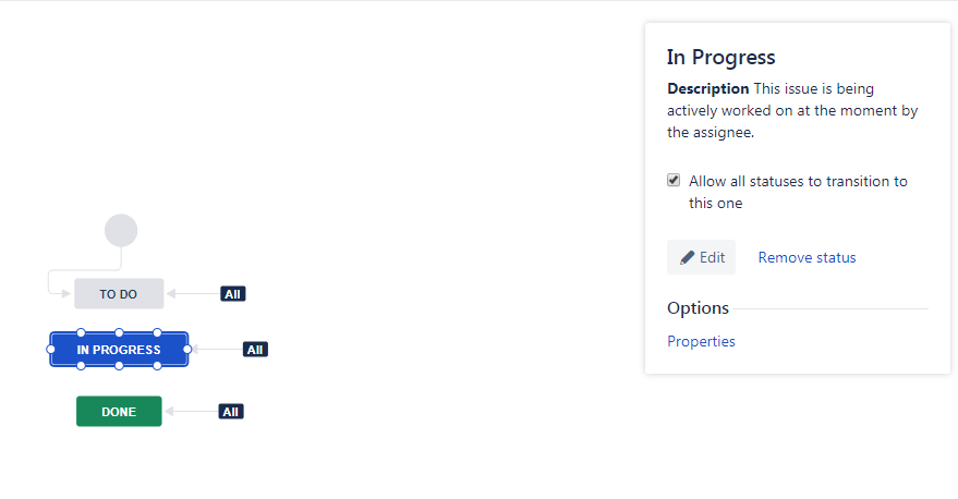

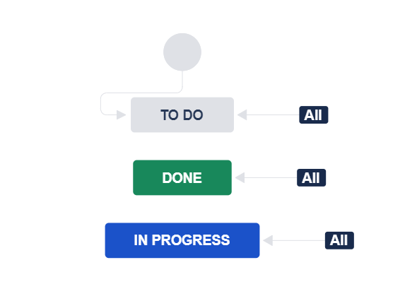

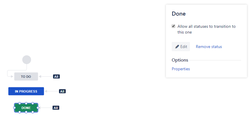

Tan Phan
October 25, 2019
Here is my workflow. I'm just investigating to family with it. So in my workflow that is right or wrong? what I need to change?
Tan Phan
October 25, 2019
Thanks,
Fixed
