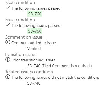

The issue we are having now: when a sub-task goes from one status to another, the parent's status doesn't change. If I remove the Comment Validator from the workflow (for every transition), it works perfectly, but then the Comment becomes optional. We need it as required.
The automation log says: Error transitioning issues "SDD-740" (Please provide the comment). FYI. The 740 is a parent issue. On one hand it makes sense because these rules and workflow apply to all types of tasks and mean that I need a comment for parent task to inherit another status (e.g. Testing).
The solution I thought would help: I added another Action in automation "Comment on issue" for the parent. And it adds a default comment that I customized, e.g. "Task is verified". However, it doesn't help despite it adds a comment and should've helped. I'm confused a bit.
Question: How to make it work and do not break the Automation?

It doesn't help in my case. It performs the operation, but the second part of the report from Automation says the same: Error transitioning issues (Field comment required)

My problem was solved. With some issues on the background, probably because the Audit log for Automation shows the same error, however actions are being performed correctly.

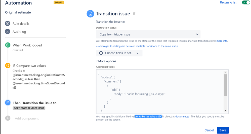

Here's their answer:
It should be possible to add the comment and transition at the same time with automation.
If you refer to the screenshot above, you will see that there is an additional section that allows you to specify the comment in JSON
John Funk
May 25, 2020
The screen shot did not come through with what you were describing, but I trust you. Glad you got it working!
Andrii Bordun
May 25, 2020
Well, Untitled.pnghope this one shows up
John Funk
May 25, 2020
It did - thanks!
