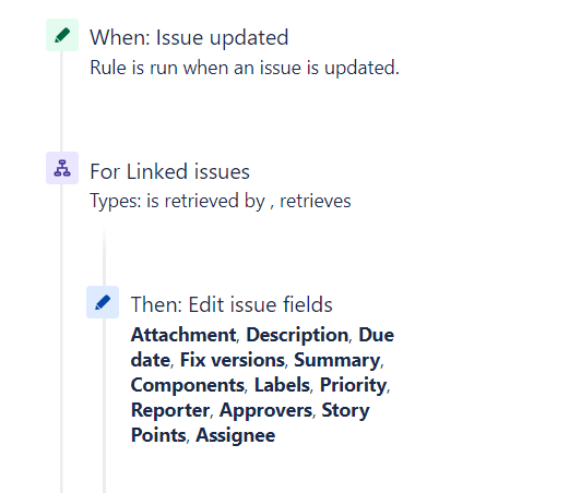

POV: issue is created in project A, it's automatically cloned into project B, and linked. If any field is updated in trigger issue (in any project), the cloned issue is updated subsequently.
I have set the automation, however, Status and Assignee are not updated in the cloned issue, they do not even trigger the rule as showed in audit log ;( Screenshot 2022-10-10 121054.png

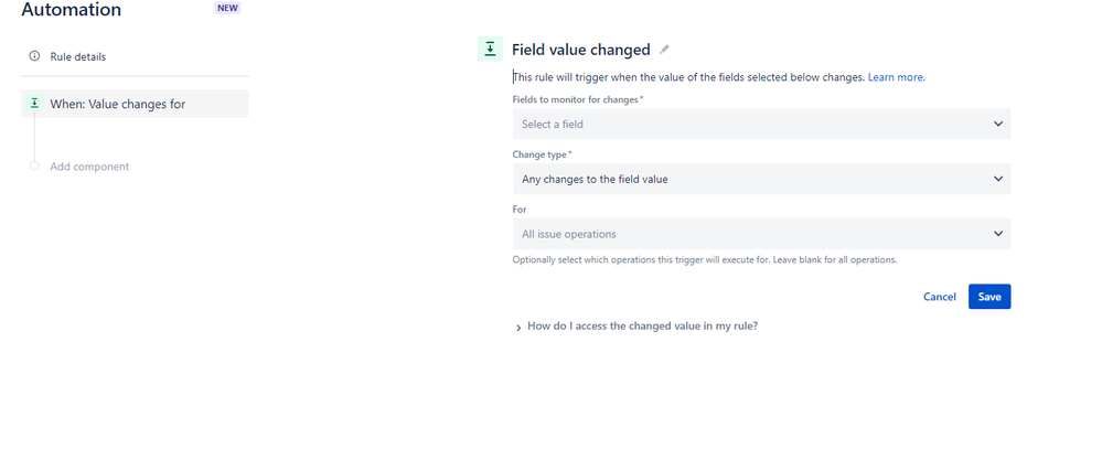

@Sophie Petenko  could you try using field value change trigger add all fields that you want
Sophie Petenko
October 10, 2022
Thank you! It's working just perfectly

Good day @Sophie Petenko
With the following topic, I would say for status, you would need a transition rule because though it is a field, the status needs to be transitioned to get to. Make sure the automation user has the transition permission.
As for the assignee, make sure the user in question can be set as an assignee(Assignable user in project B permission scheme) and the automation user can assign issues (Assign Issue in project B permission scheme).
I will suggest breaking this out of the bulk field edit change to test it first and validate that it works and then adding the step that worked for you also to the main Automation.
Regards.
Sophie Petenko
October 10, 2022
Unfortunately, all mentioned above was tried still no trigger of the rule
