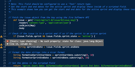

I'm new to ScriptRunner and want to check out the product. However, when I try to activate scripted field examples, I have a few problems.
The first comes from static type checking:
What I understand from this message is that the fourth argument is not declared or something like that but issue is defined just below. For the moment I can't find the solution, there are a lot of docs on the server and the docs on the Cloud don't help me or I've missed something (it's very likely).
The second, perhaps related to the first, is that I can't activate the field (I can't save it).
Could someone tell me what I've done wrong?
Thank you very much and have a nice day.

With regards to status type checking errors, those are not always indications of bad code.
It's a failure of the editor/syntax checker to extrapolate and be able to guarantee that your code is 100% valid.
In this case
issue.fields.sprint.state
It definitely knows what "issue" is and knows that "fields" is a valid attribute/method for "issue".
It might even know that fields can contain arbitrary data, but that's as far as it goes.
If you use issue.fields.summary, that's all there is, the summary is the final value.
So since the syntax checking is not sure what "sprint" is and whether it's more like summary or has other sub-fields. So it can't verify that "state" is a valid attribute for sprint.
I'm not super familiar with the Cloud implementation of Scriptrunner, but if the status type-checking error bothers you, you can try something like this:
// Check if the issue is in a sprint and if so if the sprint is an active sprint
def sprint = issue.fields.sprint as Map
if (sprint && sprint.state == 'active') {
The "as Map" will tell the static type checking that issue.fields.sprint is a Map that should contain additional sub-fields. So subsequent call to sprint.state will be allowed.

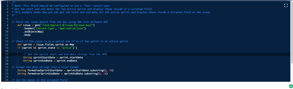

JM Perrot
October 30, 2023
Hi @PD Sheehan
Tanks for your answer, your idea works well for the static checking.
I understand the compiler logic better. Thanks for the tip !

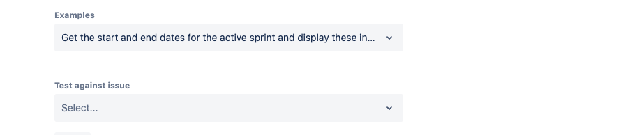

Your second issue is common as I experience the same thing when I first created a Scripted Field. You have to first test your script against an issue. You'll need to type for issues to appear. Start with the project key. One you test it then you will be able to save it. That may solve your first problem as I am able to run this example script fine. Let me know if this works for you. Screenshot 2023-10-26 at 11.47.05 AM.png
JM Perrot
October 27, 2023
Hello @Brandon Chin,
Thank you for your reply. This trick for saving work works, thank you! I was stupid, I never tried to type, I was just concentrating on my first problem. ^^
