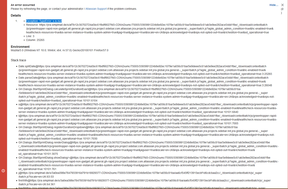

Exception: TypeError: s is null
Sprint doesnt start

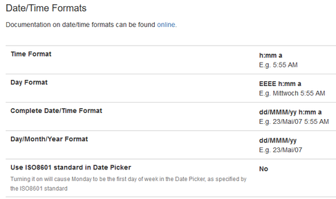

Here are our current Date/Time Formats. I already changed them before the last test.
Usually they are defined als follows:
We have no announcement banner. In safe mode it still happens. Same Exception, same line etc.

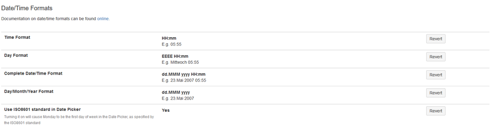

I think that Branden was looking at the possibility that this problem is caused by an unexpected date format.  From looking at your screenshots, it appears that you have set custom date/time values.  We can see this because you have the "Revert" button appear on this page.  More details on this in the KB: Starting Sprint fails with error TypeError: b is null
I am interested to see if perhaps you can revert those formats in order to see if you can then start that sprint correctly.
J. Schlottbom
January 30, 2018
Hi Andrew, pls read my post again. I ALREADY REVERTED the date formats. I have done anything I found in the Internet and what you or Brandon said.
