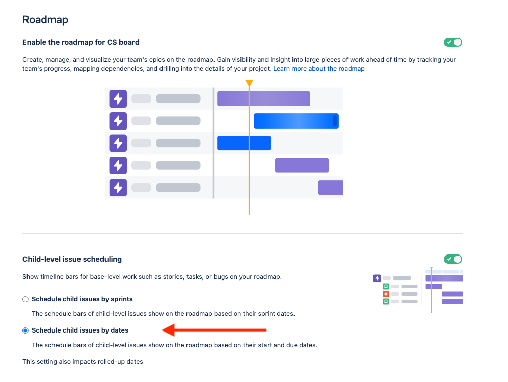

I work in a marketing team and we are looking to implement Scrum as our agile method, as I was trying to build the roadmap, I've found that my task do not show the correct timeline.
What I'm seening is that every task I build just shows the purple bar as if the start and due date is the same as the sprint and not the real one selected which is usually between the sprint.

Hello @Jose Miguel Hurtado Escobar
By default the roadmap will show the tasks with dates matching the Sprint dates.
You can change the Roadmap configuration to use start and end dates from the issues themselves instead.
May 11, 2023
Thanks a lot @Trudy P Claspill! that worked like a charm!
