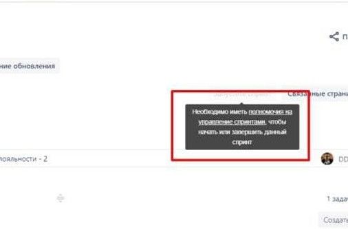

cant start sprint in jira cloud. I have manage sprint permission as a project lead.
What can be the problem here.

Hi @Stanislav ,
I don't understand the screenshot, but most often this is a permissions problem. You need the right permissions for every project in the scope of your board.

@Stanislav  , can you translate the error message and share it?
You should have the manage sprint permission for all the projects that are included in the board.. do you have?
Stanislav
February 9, 2021
"You need to have permission to manage sprint in order to start or close sprint"
But user have permission in the project to manage the sprint

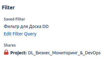

Fazila Ashraf
February 9, 2021
In the board's configuration, can you check how many projects are listed in the board's filter?
A screenshot of that section would be helpful to guide further
Stanislav
February 9, 2021
Снимок экрана от 2021-02-09 15-32-14.png@Fazila Ashraf  There is 2 boards and as i see they only use this project in query and sharing
Stanislav
February 9, 2021
Fazila Ashraf
February 9, 2021
@Stanislav  , what is the filter query?
When you run it in issue navigator, does it return issues from the DL_...&_DevOps project only? Can you specifically add the user to the 'manage sprints' permission of the project (other than inheriting it as project lead)?
Stanislav
February 9, 2021
project = DD ORDER BY Rank ASC
yes, it return only this issues

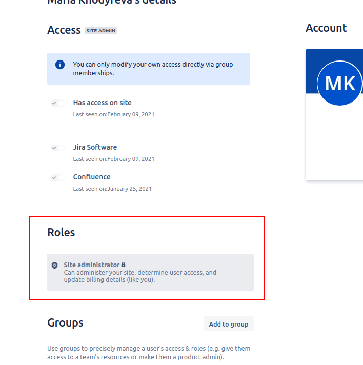

Stanislav
February 10, 2021
@Fazila Ashraf @Trudy P Claspill @Tessa Tuteleers
I found out the answer if you are interesting
Fazila Ashraf
February 11, 2021
@Stanislav  , but that doesnt make sense.. If only site administrators can start the sprint, then how many users will you add as site administrators?!
Note that it is a powerful role..
Stanislav
February 11, 2021
@Fazila AshrafSorry thats my role.
For that user who got the problem i choose role "Trusted" second one.
And that works.
Fazila Ashraf
February 11, 2021
hmm.. i just read about trusted role.. that is also a powerful role.. I wouldnt be comfortable giving that access to the users just so that they can start the sprint..
