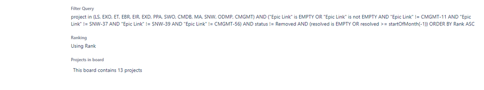

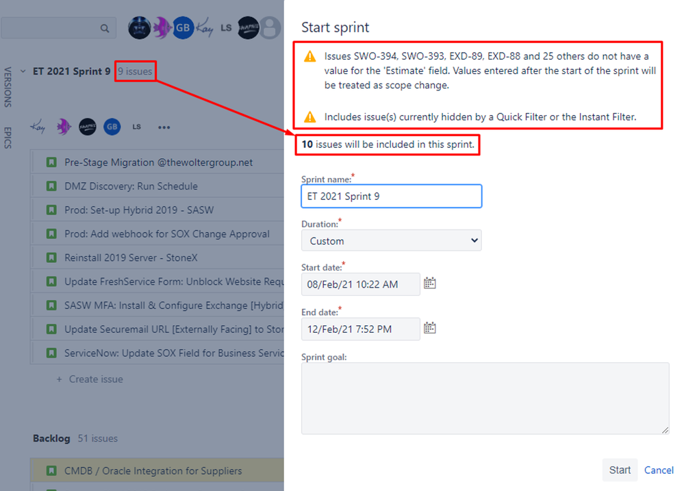

Some reason my user is receiving this issue where the correlation of the sprint total doesn't add up properly and quick filter or instant filter is showing Estimate field.  I've also attached the error and attached the current filter query below:

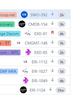

Sanka Insomphou
February 8, 2021

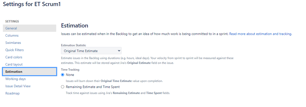

Sanka Insomphou
February 8, 2021

Sanka Insomphou
February 9, 2021
So i went to one of those 25 issues and set the original estimate time and the warning went from "25 other issues" to 24 issues.  as you suspected, they do disappear from the warning list.  would the best course of action be removing a quick filter or do i recommend my user to update all other issues with the Original estimate?
