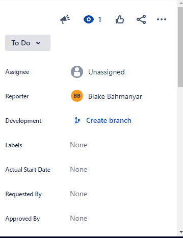

No, there is only one custom field named "Start date." I did notice though that the "Start date" field is not shown on the right hand side of the issue page (see picture). My hunch is there needs to be a field there for it to map properly... is this the case? If so, how would I or an administrator create a field there for it?

Start Date may not be showing in the right-side pane, but it may still be part of the fields that are available.
If you scroll down in that section there will be a link for showing fields that have been hidden because they are empty, and there will be a link for Configuring fields. Note that this is just configuring your view of the fields available within the projects.

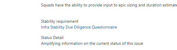

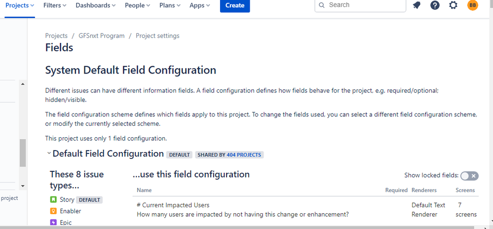

Thank you for the detailed steps. It is a company-managed project. I do not see "Start date" as an available field when clicking Configure Fields, or when clicking "Fields" on the left-hand side as pictured below.
I guess "Start date" would be here if it was available to the project:

Correct, Start Date would need to be listed in the Field Configuration that is used for the issues in your project in order for you to access that field.
If you don't see it in the list, that suggests that the field has not be added to that Field Configuration and possibly that the field was never created. A Jira Administrator can confirm that the Start Date field exists (Settings > Issues > Custom Fields) in your instance and can add it to the Field Configuration Settings > Issues > Field Configurations) that is used in your project.
