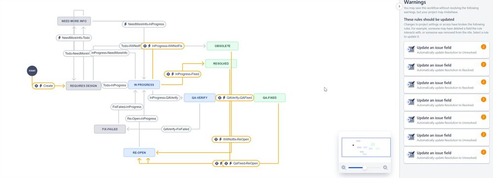

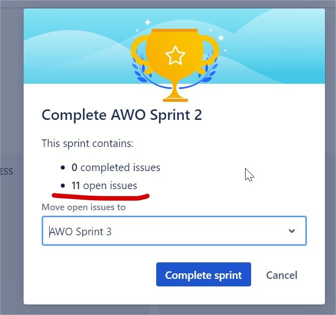

Hello,
I have created a custom flow for my issues and I noticed that when I Complete a Sprint it will transition all my resolved issues to the next sprint. This is extremely annoying.

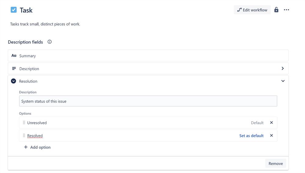

After reading a few forum posts I seem to have found that the Resolution field needs to be not empty for it to be completed in a sprint (Why? - why not just use the status for that *shrug* ) So I have added a Resolution field with "Unresolved" and "Resolved" field values.
I have then created a rule for each transition that is supposed to modify the field to the appropriate value. I get a lot of warnings with no indication what is wrong. I verified my transitions are indeed setting the value of the Resolution field. But the sprint still will consider them as open issues.
I attached some screenshots to illustrate the problem.
Anyone knows what I am doing wrong ?

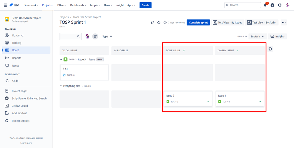

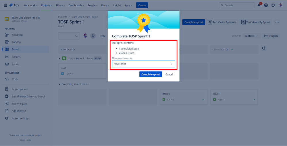

I believe the screenshot which you have shared and the Resolution field which is visible is the custom field
Make sure the Issue is in Done Category (Green) and the last column on the board
Here are reference examples from my board
1 - There are two Done Category Status - Done and Closed
2 - When I try to complete the Sprint it recognizes only the resolved issues with Done category and last column board issues
Let me know if you have any query
Thanks,
Pramodh
