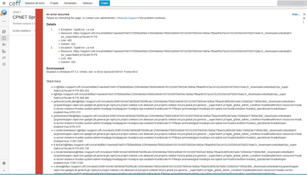

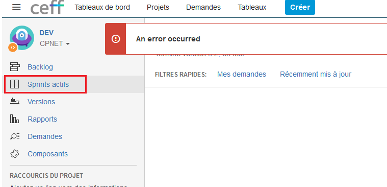

Now, when I go to "Sprints actifs", I have "An error occured".
See capture.
Can you help me please ?

This is the problem : https://jira.atlassian.com/browse/JSWSERVER-15185
If I put english, it's working.
The version 7.9.0 correct this.

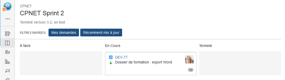

If I check the button "recent update", I see my ticket. If I only check "My requests", it's empty. If I unckeck the two button, I have the error.

April 10, 2018
This can sometimes be caused by problematic scripts in the announcement banner, or third party plugins.
  • go to JIRA Administration > System > Announcement Banner, if there is any embedded script here, try removing it temporarily and see if it helps.
  • try disabling user installed plugin by enabling safe mode in JIRA Administration > Add-ons > Enter safe mode

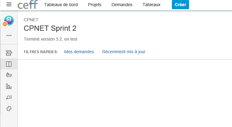

2. I try enabling safe mode. I don't have the error but the screen is empty, show capture.
What doing to resolve the issue ?
