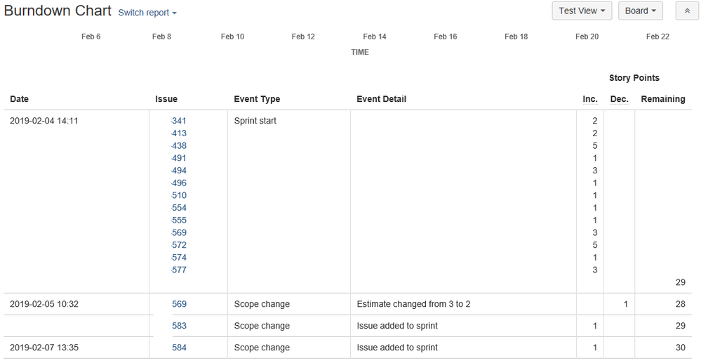

In the sprint report.png you can see that we have finished 496, 510, 554, 555, 584.
In table.png you can see that all of these are in the sprint from the sprintstart, this without any Event types has occured, except for 584 (this one has a scope change because its added in the sprint).
In table.png we expext to see a new row for every issue that's finished.
Even in burndown report.png You can see that the line does not drop/change even thought issues are finished.

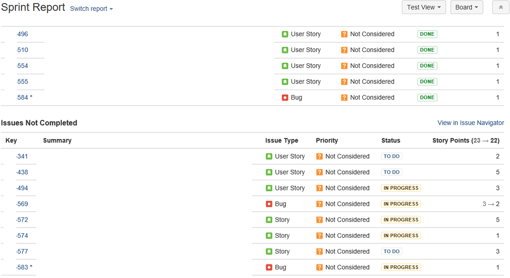

You can open the Sprint report. There will be a table with all issues. You can see which issues were added after sprint. You can see which issues are considered completed.
Helen Ahlberg
February 15, 2019
Helen Ahlberg
February 15, 2019
This is my sprint report - so what you are saying is that the 8 story point that have been completed will show progress in the first picture - but they do not.
It also seems like there where now issues added after the sprint had started...

There must be a table under the burn down chart, could you paste the screen shot here?
Helen Ahlberg
February 15, 2019
OK - I found this and it seems like they have done some changes after all
But not that much...
