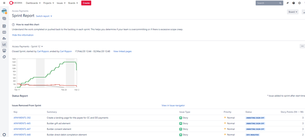

I'm probably being really dense.  If I look at a sprint report for a previous sprint, I see the following within the report.  JIRA1.png

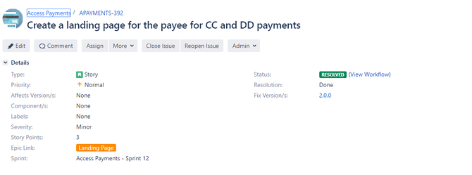

But when I go into the individual items the "Status" field shows differently.  Anybody know why this might be?
I wondered if it might be a historical status that was the state at the time the sprint was completed but this doesn't appear to be the case.  Is it not the status of the story but rather something else?  So confused....

Hi @Timothy Wintle
It is the historical status of the issue when the sprint was completed, not the active status of it today.
You mention it doesn't appear to be the case above - is this not the case for your issue? You can check this by comparing when the sprint was completed with the transition history for the issue under the "History" tab in the issue view screen.

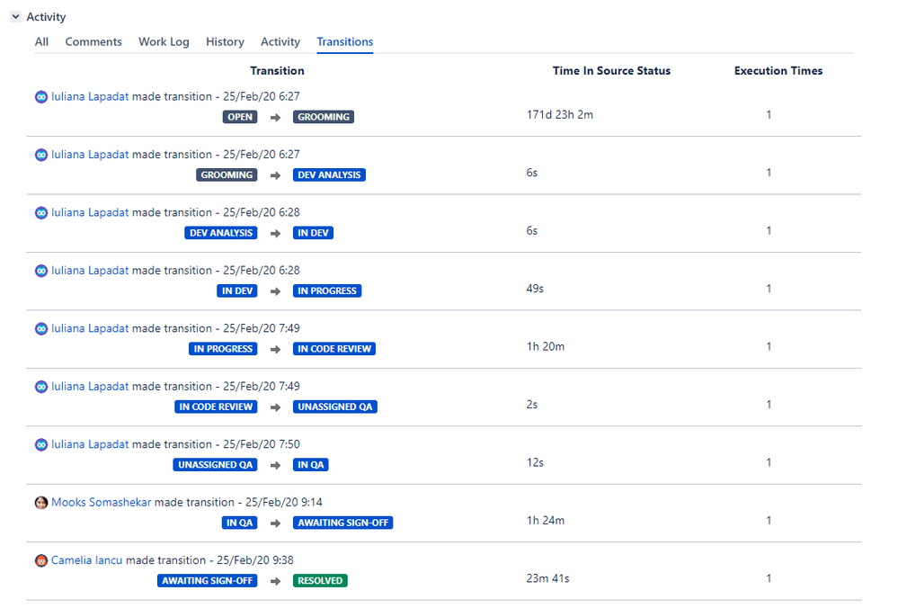

Thanks for your response.  Looking specifically at APAYMENTS-392 I have the following transitions having happened
Status.pngIf it were a historical status, it should have been the status as per the 2nd March when this sprint was concluded which as you can see from below would be "Resolved" not its predecessor of "Awaiting sign off"
