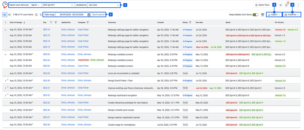

Natalia_Kovalchuk_SaaSJet_
August 10, 2026
Hi @Harshad Prajapati !
Yes, you can create this type of report using Issue History for Jira (Work Item History) from the SaaSJet team.
In the app, you can select the required project or sprint. Then, use the Column option to include the fields you want, like Sprint and Fix Version. The report will display historical changes, showing the previous value, new value, and the date/time of each change.
After you configure the report, you can easily export the history to Excel or CSV for additional reporting or sharing.
This is especially helpful when you want to track changes in Sprint or Fix Version across various Jira tickets instead of checking the history of each of them individually.
Hope this helps!
