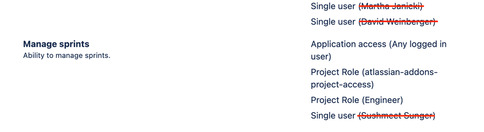

Can you confirm that the users have the Manage Sprints permission in the "IN" project?

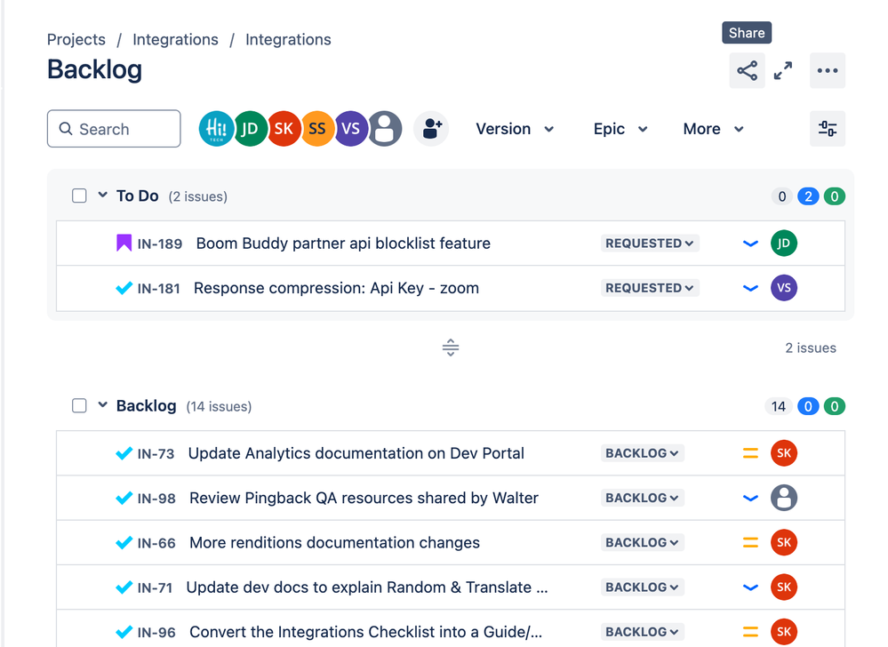

Good Afternoon Trudy! Here is what we are seeing, maybe the answer is one that is staring me in the face? Thanks so much for your help!A49DDFAA-24AD-4F22-B24C-6AE0675CFE98.png3761EB0D-CD78-46D5-93BA-FA75F9E742CD.png

That does not appear to be a Scrum board. It appears to be a Kanban board.
Can you check the project type for the project? Get that information from the View All Projects page under the Projects menu, looking at the Type column.
If it is a Team Managed Software project you can toggle between using the built-in Scrum board or the Kanban board. Do that from Project Settings > Features, enabling or disabling the Sprints feature.
That toggle is not available for Company Managed Software projects, but you can have multiple boards, both Scrum and Kanban, referencing the project. You can check other boards associated with the project to see if any of them are Scrum boards. If there is not already a scrum board for the project you can create one. Refer to this documentation for instructions:
