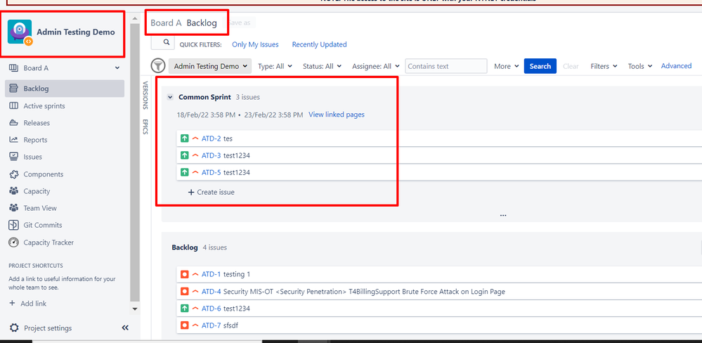

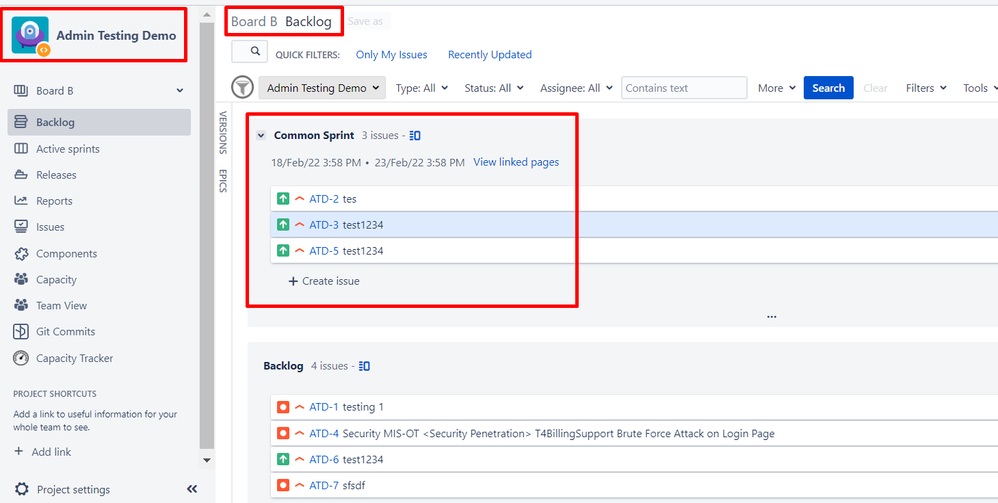

The backlog issues of board is based on the filter which you configured for your respected board.
If you can see same sprint under 2 boards that means you are using same filter please confirm once.
If the issues which are already link with one sprint then those issue should not be visible in the backlog section for other board. I have tried this and i am not seeing already map issues in the backlog. Please see the screenshot.
Perform the indexing once for the project and check.
Thanks,
