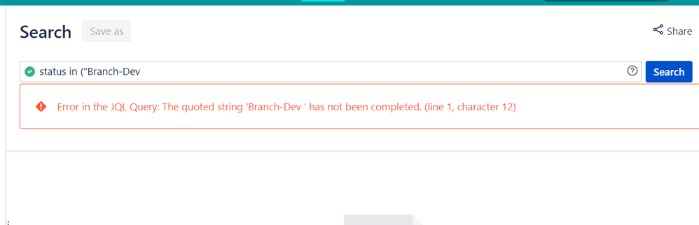

The JQL for the " In progress" part of the gadget seems incorrect , the JQL being used to fetch the data is broken/incorrect /incomplete .When I update/fix this JQL , it is not saved for the gadget ; the gadget still uses the incorrect/broken JQL
Nic Brough -Adaptavist-
May 3, 2019
Well, no, you can't save broken JQL.  Try correcting the incorrect search and saving it.
May 6, 2019
Look at the screenshot you gave, note that your query is wrong and the error message in red is telling you what the problem is.  Correct that first, then we can look at everything else.

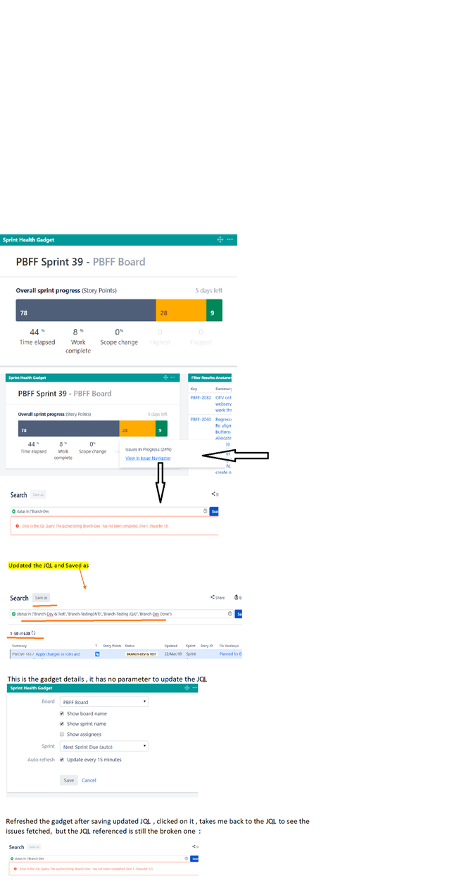

Jagriti
May 6, 2019
That is a built in query used by the gadget ,when i try to fix  this JQL , it does not save.
May 6, 2019
It's not the built-in query used by the gadget - it can't be because it doesn't work.
Please, correct it and see what it returns in the issue navigator - we need the list of issues you are reporting on to see why the gadget might be wrong.
Jagriti
May 6, 2019
Thanks Nic but I Updated it , it does not help.
Please refer my attachment to see the steps i have been performing , is there anything i am missing?
May 7, 2019
Ok, I think there's a bug in the "look at this issue list" function there, not the JQL the gadget is running.

Status break down:  In progress ( this includes following interim in progress statuses- Branch-Dev & Test","Branch-Dev Done",Branch-Impediments,"Branch-INT Done","Branch-Testing(INT)","Branch-Testing (QA) )
Gadget return : no value , errorstatus in ("Branch-Dev         Error in the JQL Query: The quoted string 'Branch-Dev ' has not been completed. (line 1, character 12)
