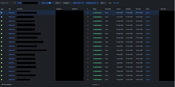

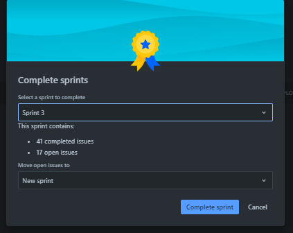

I cannot complete the sprint, because warning says i have 17 open issues, but i have already mark that 17 issues with status that mark the resolution to "done"
17 open issues, but i have all resolution to "done"
Filter only "task" and "story" within sprint-3, a total of 17 issue

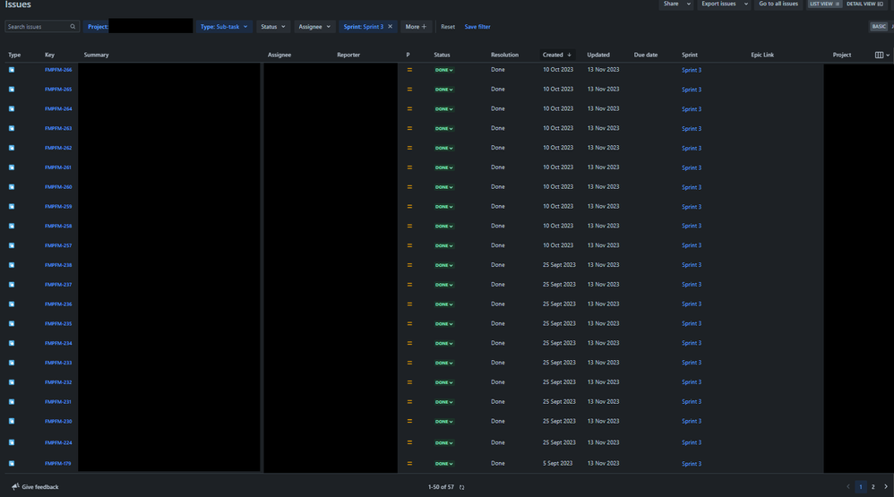

Filter for all Sub-task within that "story" and sprint-3 , but for the total of sub-task is 57, no match for 41 completed issue or even 17 open issues.

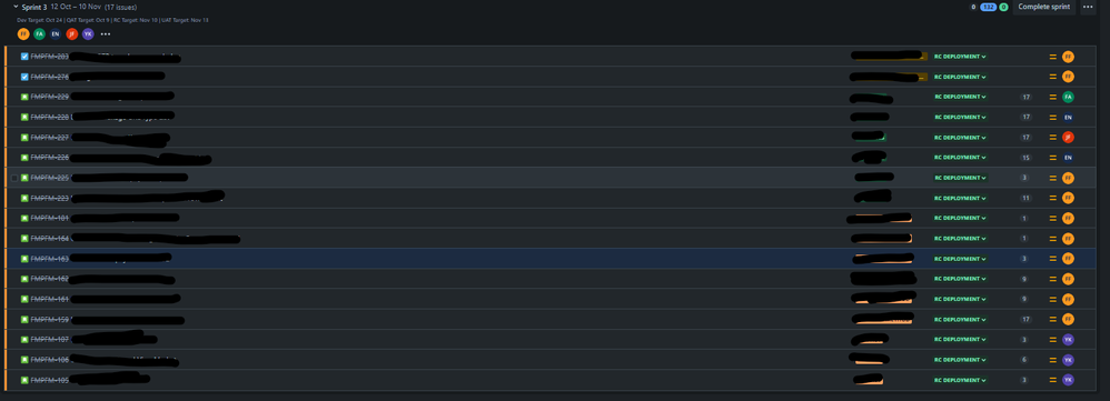

i just tested add another issue on backlog without attach it to sprint-3, and i change the status from to-do to RC Deployment, when status in to-do. the "complete" sprint from sprint-3 still only have 41 complete issue. but then after i change status to rc deployment, the "complete" screen page from sprint-3 change to 42 complete issues.
so the sprint 3 complete issues too acting funny because it may look-like related to issues on backlog

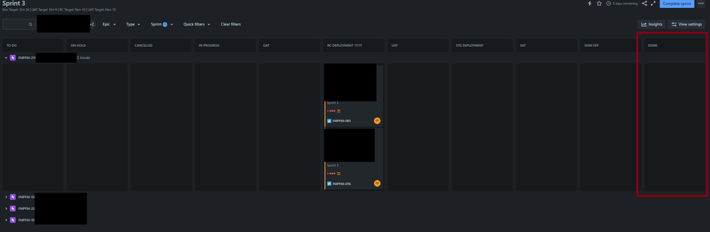

Jira considers issues in a sprint to be open as long as they are not in the rightmost column of your board. That is most likely what is happening here. Status or resolution don't matter here, just have a look where the issues are on the board and have a look in your board settings how you have mapped statuses to columns.
Hope this helps!
Andrew
November 13, 2023
hi @Walter Buggenhout
thank you for the response, for the rightmost column did you mean this column "done",
to make all issue is completed, i need to place it on done column right?
Walter Buggenhout
November 13, 2023
For issues to be considered complete in this board, yes - that is the column they should be in.
