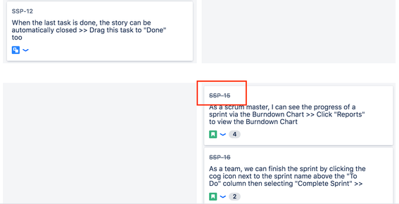

Also when you look at these issues in the last column of the board, are the issue key shown with a strike-through?
Or do they display normally?

I have resolution value set in my workflows and yes issue key is shown with a strike-through when closed.

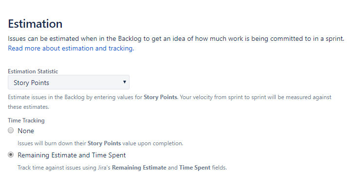

I am interested to learn more about what estimation and tracking values you might have set for this board in question.  You can find more details about configuring this in Configuring estimation and tracking.  What values do you have set for both Estimation statistic and for Time Tracking on that board?

As mentioned earlier, I use "Story points" as my estimates for standard issue types and "Remaining Time Estimate" for sub-task issue types.
I have "story points" as estimation statistic & for time tracking i have chosen "Remaining estimate & Time spent". (attached screenshot for reference)

Thanks for clarifying.  The use of subtasks here I think is a key factor.  Are you finding that the parent issues are being closed before all their subtasks are completed?  If so, I think the burndown chart expects to have the parent issue continue to track the estimations of all the subtasks.  Please see the documentation in Understanding the Burndown Chart.  Specifically:
Subtask behavior when remaining estimate and time spent is enabled
 Time estimates of subtasks are rolled up to the parent task.
This means that the parent task will have the total sum of all remaining estimates of the subtasks.
In this setup, I could still a scenario where open subtasks could count their time against the parent issue even when closed.   In other situations like this I have found that users will tend to want to prevent closing the parent issue until all the subtasks are completed.
