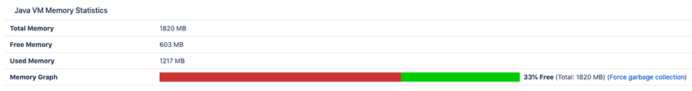

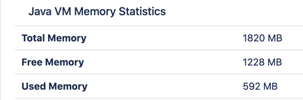

Kale Bullen
November 5, 2020
Hi @Daniel Eads
So to touch on the memory in the box. Please see attached.

Daniel Eads
November 6, 2020
Thanks for the extra info! Given all the above (particularly the default heap application of 1820mb), I think the most likely scenario is still the slowdown being caused by a full garbage collection. Since you mentioned it's been some time since this slowdown has happened, it's possible your GC logs have rolled over and wouldn't show the last memory exhaustion.
As a preventative measure, you might consider increasing your Xmx value by 512mb if there's enough free RAM on your server to do so (and still provide the base operating system with enough RAM to carry out its operations safely) - for example you would probably want to ensure the server had at least 6GB of RAM total if Jira and nginx are the only applications running on it, and increase the Xmx value to 2332mb.
We've got guidance on increasing your heap size on this article . Setting the Xmx (maximum heap size) and Xms (minimum heap size) to the same value can also help reduce the time it takes for a GC to complete.
Since you've not noticed this issue in some months, I'm thinking it's likely that just a preventative boost of the heap size may stave off issues for you going forward. By all means, keep learning about the GC allocation so this is less likely to be a mystery - but from what you've seen so far, I think tuning the Xmx/Xms slightly might be a quick way to ensure stability in the coming months.
