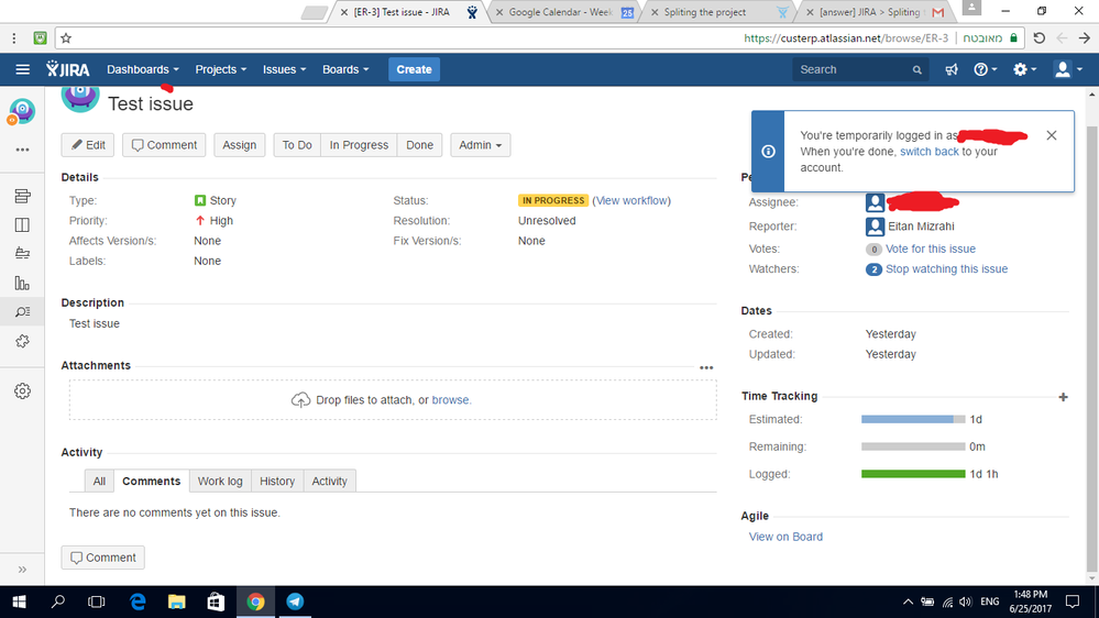

No, you said you can't see a button for "splitting", and you're right, there isn't one.  Because there's several ways to do it, with different descriptions.  Creating sub-tasks is one way to split up a story.  (Cloning and Create/edit are the other two obvious ones)
You should find the "create subtask" under the actions menu (hidden by the "other user" warning box in your screenshot).  If it's not there, then your project does not have any sub-task issue types configured.

OK. I have logged on as the other user - didn't see the button and neither on my own user loggin, when I choose an issue.
No button related to create subtask etc..
Maybe I don't understand, but how can I configure sb-task issue type?
Give me some guidlines, please.

Nic Brough -Adaptavist-
June 25, 2017
It's not a button, it's a menu action under the "more" or "..." menu to the top-right of the issue.
To configure the types, go to project administration and find the "issue type scheme".  You need to make sure that there is at least one sub-task type in there.
Eitan Mizrahi
June 25, 2017
Thank you - found that (There is no "more" but there is "...").
