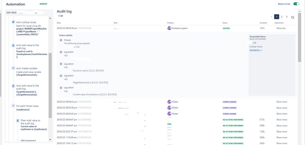

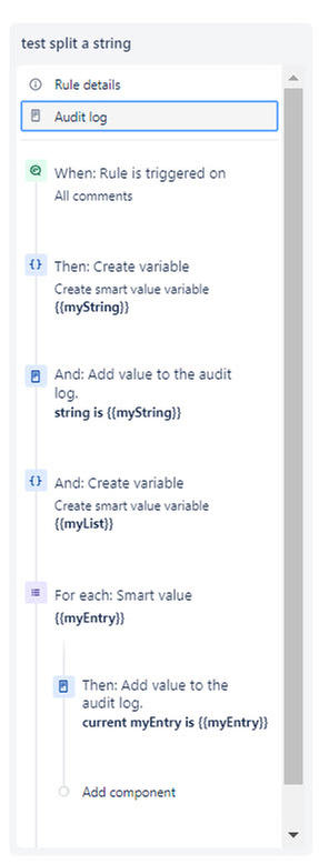

Hi,
I'm traying to split a string and then iterate over the resulting array members.
The string is:
The split action is:
The result is:
The iteration attempt:
And finally the current value inside the loop is:
What am I doing wrong?
Thank you.

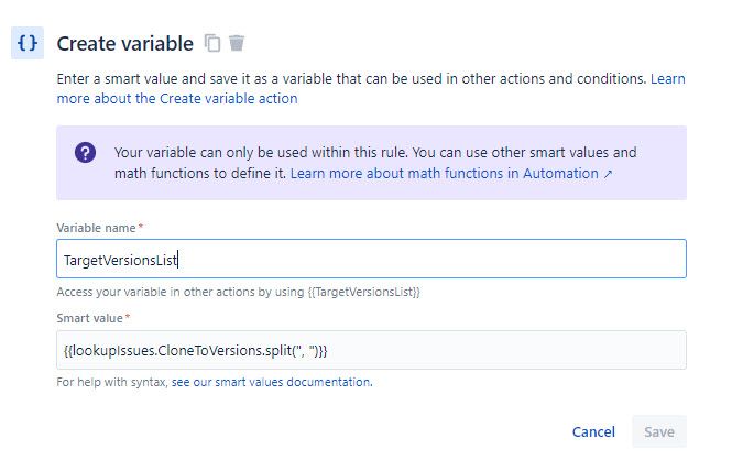

Hi @Inna S

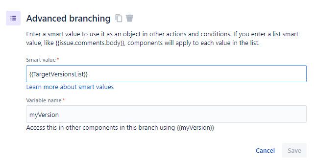

In your images, you are showing multiple different variable names for the smart value expressions, and they do not seem to match.
For example, the Advanced Branch is showing {{TargetVersionsList}} and you do not show what that contains.  Normally the branch is where the split occurs on an object or string.
Would you please post an image of your complete rule and audit log details?  Those may provide more context for what you are describing.  Thanks!

Oh, sorry, I renamed the var and it is now TargetVersionsList, the result is the same:
Bill Sheboy
March 29, 2023
Without seeing your complete rule, I suspect another problem is there is no split of the variable before it is used in the advanced branch.

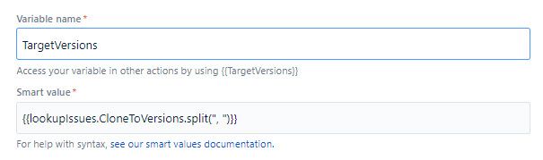

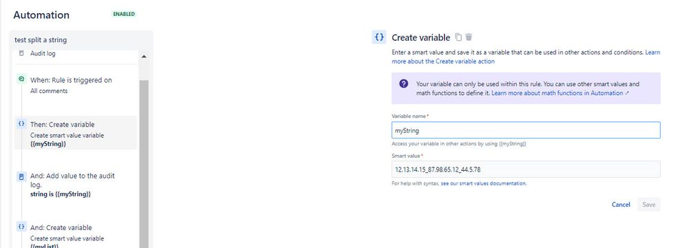

This split trouble is what brought me here:
the field that gets read correctly is a string, as shown in the 'found on card' log entry.
And then the split is supposed to happen, as shown above.
And this split just does not work.

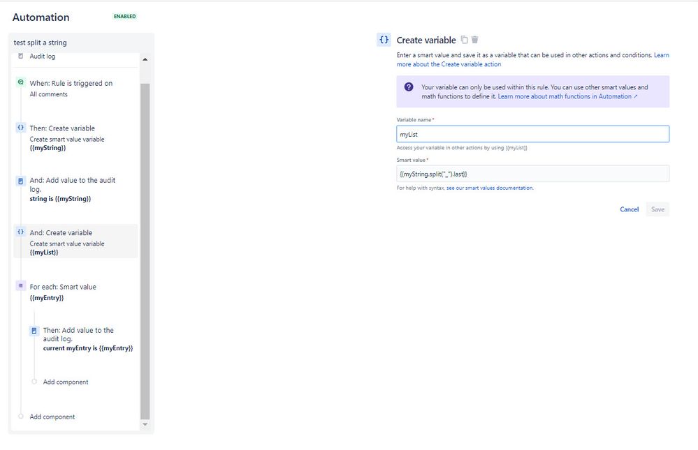

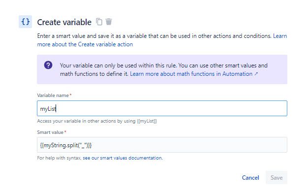

Ok, I've replaced the coma (",") with an underscore ("_") in the string, and found that the resulting var is in fact the list.
But I can't seem to access an individual member of the new list.

When you have a list, you can access a specific item by: first, last, an index with get(index), or by match() with a regular expression.
If you instead need all of them, try the split() to feed the advanced branch.

It's funny, when I add ".last" to the split statement, it brings the second part ok.
So the split works, but the loop does not bring 'every item' in the list.

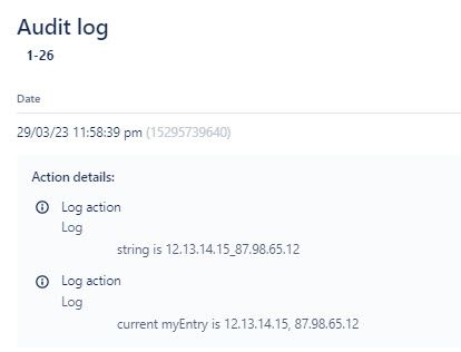

Based on what you show, the audit log does show each value is getting processed.  If the advanced branch still matches your earlier images, this seems correct.
What is not working as you expected?
Inna S
March 29, 2023

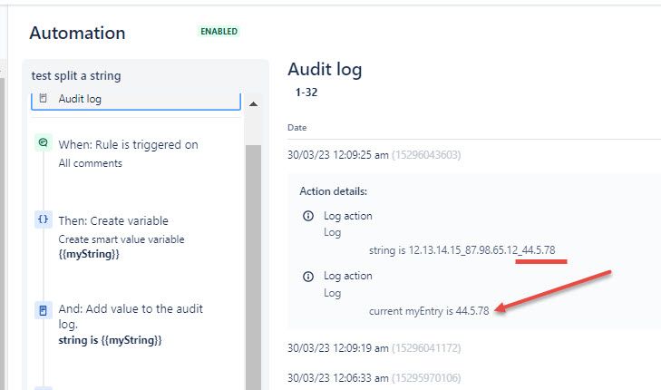

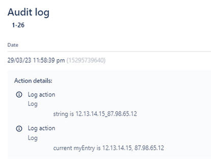

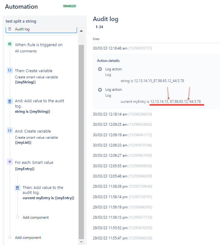

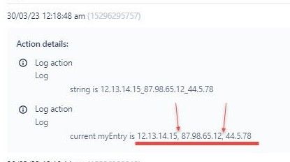

The 'current' entry is expected to be set to each of the, 3 in this case, parts of the string. This log action should appear 3 times in the audit log and not once. Otherwise how can I take action on them one by one?
Say, I need to clone the issue for several releases.
Bill Sheboy
March 30, 2023

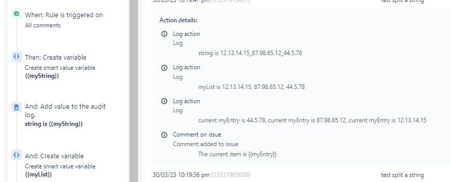

Yes, I understand what you are saying: you expected to see this three times:
"current myEntry is ..."

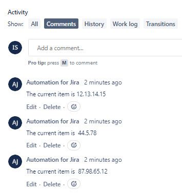

For some design reason, the implementation of branches is "smart" in that it collapses these down in the audit log because the prefix is the same, even though the loop does process three times.  I personally consider this as a defect...regardless...

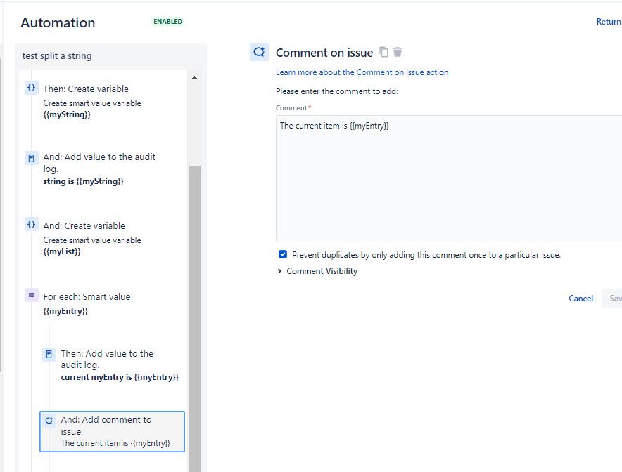

You can confirm this is indeed processing for each by doing something the rule cannot, either your desired action (i.e., clone the issue) or to write a comment with the same text to the issue.
Inna S
March 30, 2023
Unfortunately this does not work

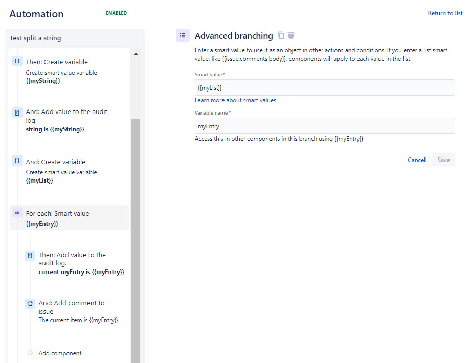

Bill Sheboy
March 30, 2023

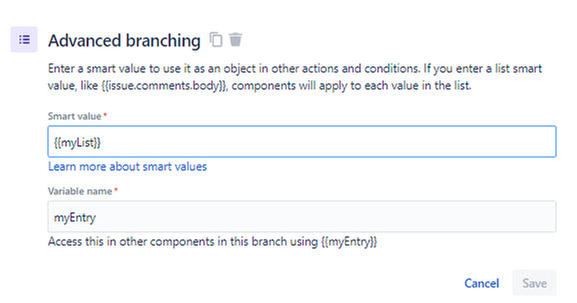

Please post an image of the advanced branch action for myEntry.  Thanks!
Inna S
March 30, 2023
Bill Sheboy
March 30, 2023
That appears to be the cause: a created variable is text, not an object or list.  Please try splitting the variable in the advanced branch source with:
{{myList.split(",")}}
Like Inna S likes this

But I still do not see why the original split replaces the "_" with "," in a string instead of creating an array?!
Bill Sheboy
March 30, 2023
I am glad to learn that worked!
Regarding your question about the first split on underscores...
The first split on underscore created a list (not an array), and when that was then put into the created variable, it was automagically joined back into a text string separated by commas.  Effectively it did this:
"12.13.14.15_87.98.65.12_44.5.78".split("_").join(",")
If you had seen values with square brackets, that would be an array...but you could not use the list functions on that value.  It would require more functions to convert to a list.
