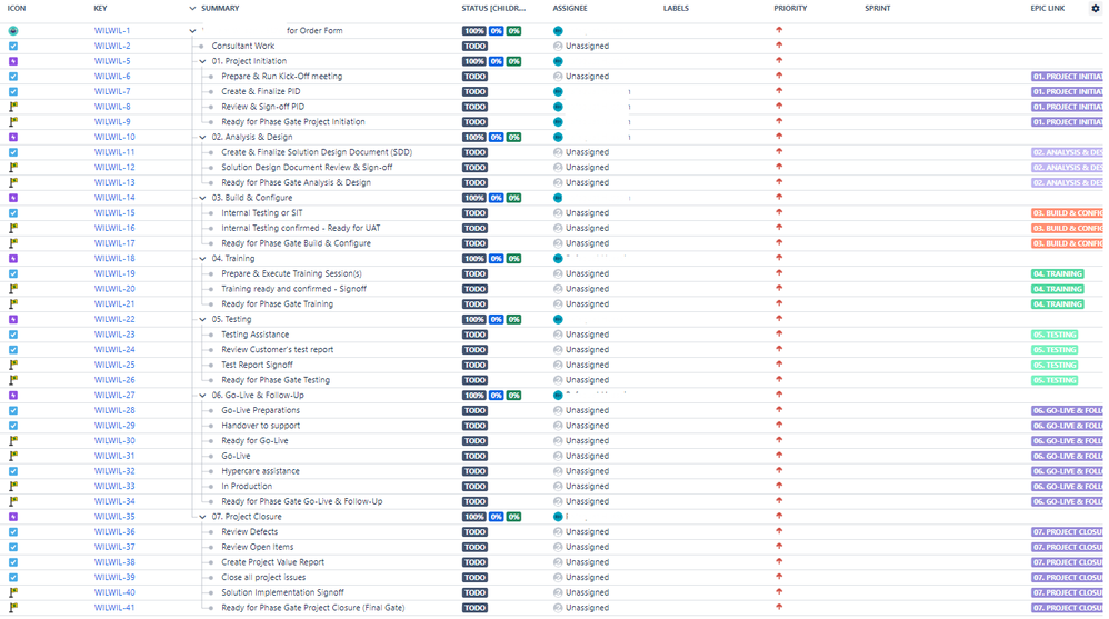

I have an automation rule that creates Epics and Tasks within the Epics in a project, and also does some other stuff. It's quite good and saving our project manager lot's of work. It results in a nicely structured project setup in Jira:
Now since there are quite some tasks to be setup in our projects, and I also need to create and use some smart values in this rule, I am nearing the 65 components that are allowed per rule.
