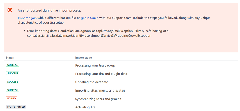

I tried to copy and restore...and it fails. Error msg on users. restore_user failure.PNG
The cleaner option is to export and then import. I suppose that means filter by project and then csv/xml. the csv option is only avail if I filter the issues. I want to try that, but at the moment, my new target site has now been "locked" and can only be unlocked if I re-do the restore :-(
