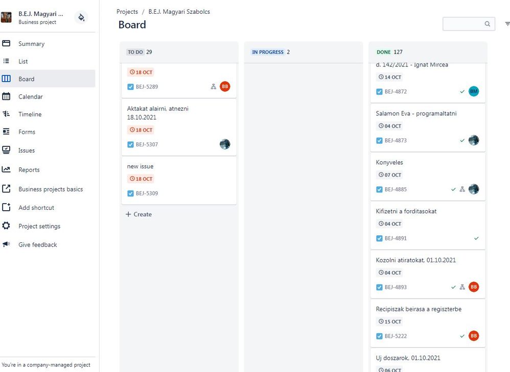

I use business project in a company managed project.
I would like to sort my issues by due date. At this moment if i create a new issue, i set due date, the issue will atomatically appear at the buttom of the board.
What i need, for ex. if i have 3 issues:
issue1: due date - 10.11.2021
issue2: due date - 15.11.2021
issue3: due date - 08.11.2021
I need that they appear in that order on the board (from up to down): issue3, issue1, issue2.
Could help me somebody ? :)
thank you,

Hello, thanks for your response. I don't use backlog, i have only TO DO - In progress - DONE, sot it is not a problem to disable the ability. The problem is that i can't or i don't find where should i change the configuration for the board. It is possible that i use a board, a project that does not allow to change ?
Magyari Szabolcs
October 20, 2021
For ex. i try this solution: https://support.atlassian.com/jira-software-cloud/docs/configure-a-company-managed-board/, but i don't have the 3 ( ... ).
Nic Brough -Adaptavist-
October 20, 2021
Either you are not a board administrator, or you are using a team-managed project or business project.
