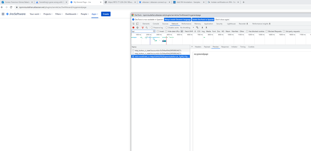

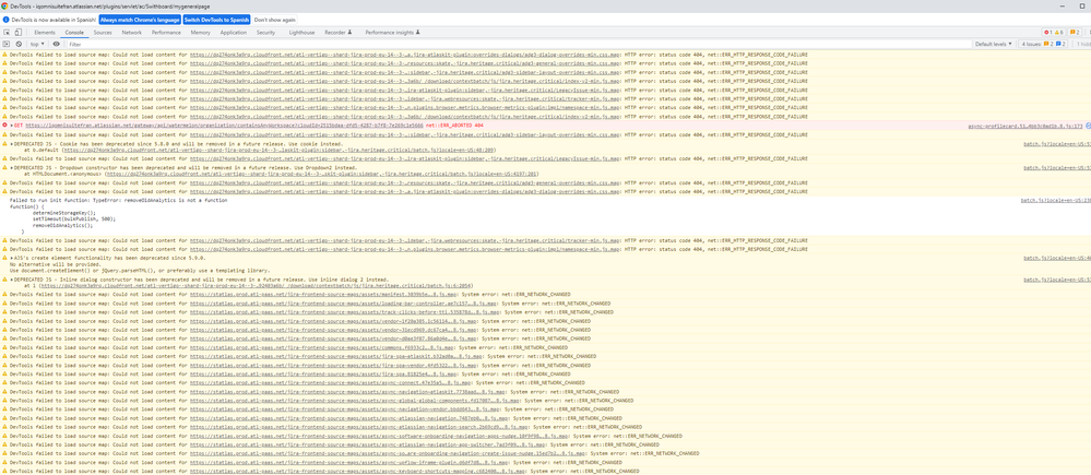

Francisco Gomez Balastegui
November 9, 2022
Hi, it looks like it is not related to my ngrok
if we check, my endpoint response correctly
