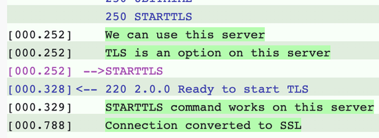

Testing your mailserver to see if it uses STARTTLS
Use the check TLS tool to enter your mail server's address and see if it responds with a STARTTLS confirmation
If it does, continue on to collect and import the mail server's certificate into Java's keystore!
