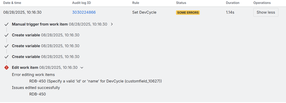

Applied, got the following error:

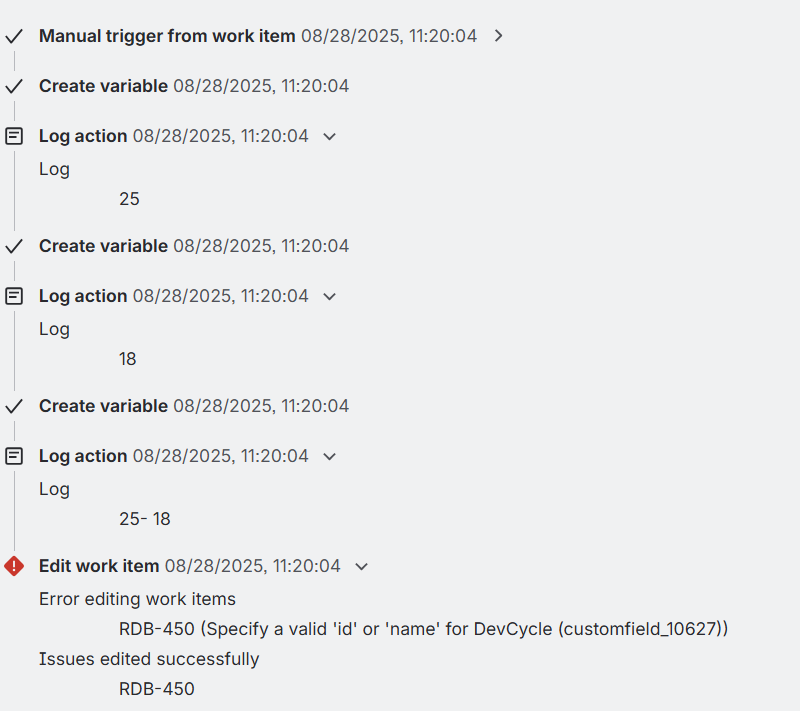

Dd
August 28, 2025
We are close.
I added the LogAction steps and here is what I get:
The format is correct - it just won't accept it. Could it be the extra space between the dash (-) and 18?
I don't have spaces in the rule itself (when concatenating the 2 values, no space in between). The only thing I can think of is that week componenet generates that leading space:
{{#=}}ROUND( {{now.format("w")}} / 2, 0 ) {{/}}
Bill Sheboy
August 28, 2025
Thanks for those updates, @Dd
Would you please show the details of your edit action, including the JSON expression?
I hypothesize it "thinks" you are trying to use the field option id rather than the value attribute.

Dd
August 28, 2025
Still getting the same error.
I have a feeling that the CurrentDevCycle is "25- 18" with a space between the dash (-) and the 18 and therefore an illegal value.
Is there a way to get rid of that?
In the meantime - I'll test that
Dd
August 28, 2025
Confirmed!
I added the "25- 18" with the blank and it worked.
I can probably change the values but that would be giving up :-(
Is there a way to get rid of the extra blank?
Dd
August 28, 2025
omitting the dash: {{varYear}}{{varBiWeekly}}
Resulted in "25 18"
Bill Sheboy
August 28, 2025
Something is up...I just re-tested exactly what I posted above and it worked with no extra  / embedded spacing.  If you post images of each Create Variable action that will identify the cause.
And just to confirm, you are using Jira Cloud, correct?
Dd
August 28, 2025
Yep - Jira Cloud
varYear: {{now.format("yy")}}
varBiWeekly:  {{#=}}ROUND( {{now.format("w")}} / 2, 0 ) {{/}}
CurrentDevCycle: {{varYear}}-{{varBiWeekly}}
Dd
August 29, 2025
It worked!
I removed all redundant blanks and it worked!
Was:: {{#=}}ROUND( {{now.format("w")}} / 2, 0 ) {{/}}
Now: {{#=}}ROUND({{now.format("w")}}/2, 0){{/}}
I don't know which blanks made the change but it worked. Any idea?
BTW - where can I find documentation on all the different operations on smart values you performed?
BTW - what will happen when I get to Week 1 in 2026?
Thanks!

Bill Sheboy
August 29, 2025
Regarding the spaces...without seeing your actual rule actions, I cannot guess on the cause.  Even with the spaces inside of a math expression, those will be eliminated, as they were in my testing.  And so the extra space is likely from one of the other rule actions.
Finding "documentation" on the various smart value features...requires two things: when the docs mention links out to Java documentation, go read that also; and, always experiment with simple test rules to confirm the behavior.  Unfortunately, there are many errors in the docs and a test rule with a write to the audit log helps validate behavior.  For example...
For week 1 in 2026...you could quickly test that with a rule:
  • use a Scheduled trigger with no JQL
  • create a variable, such as varTestDate, with a value of 2026-01-01
  • convert that with toDate and use it in the expressions, written to the audit log
    • {{#=}}ROUND({{varTestDate.toDate.format("w")}}/2, 0){{/}}
  • run the rule, adjusting that first date to check the behavior in the log
Like Dd likes this

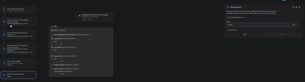

Duc Thang TRAN
August 26, 2025
Hello @Dd
For Week divide by 2
{{#=}}{{now.weekOfYearIso}} / 2 {{/}}
For year with 2 digits and exclude 0 for exemple 2009
{{now.format("yy").replaceAll("^0","")}}
So combine 2 sections i think is
{{#=}}{{now.weekOfYearIso}} / 2 {{/}} - {{now.format("yy").replaceAll("^0","")}}
Hope this can help :)

Duc Thang TRAN
August 28, 2025
Something like that @Dd
During the test, I'm using a date-time field  then get information: week number divided by 2, and the year in 2 digits.
In exemple : Jun 12, 2007, 2:00 AM
Then edit the Equipe (select list). You need to create all values as needed. Here is the config and audit log

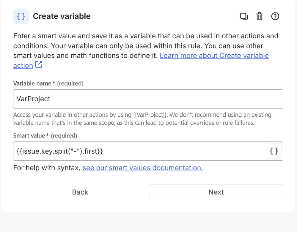

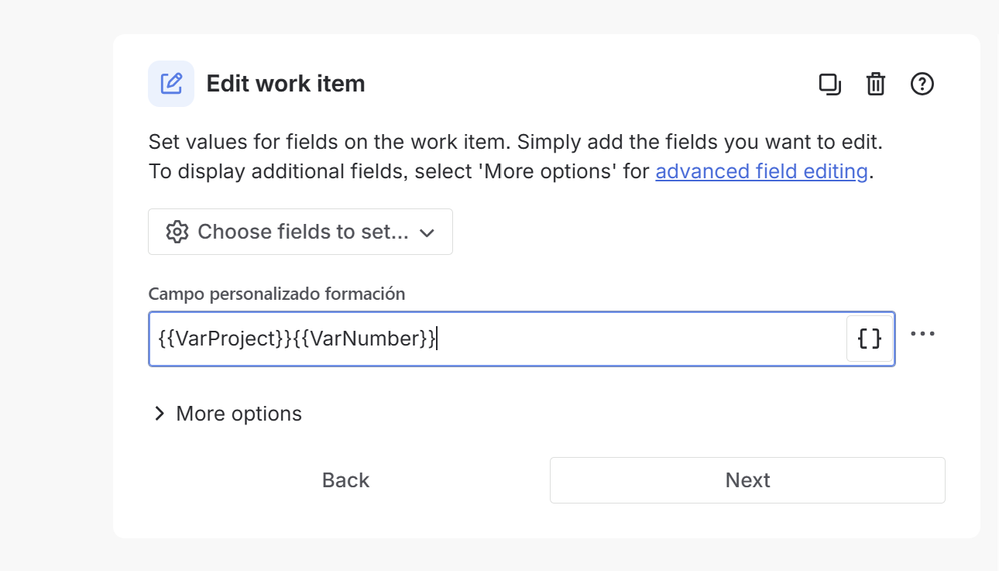

Pedro Olmo
August 26, 2025
Hello @Dd ,
I would, for example, try splitting that field as in the screenshots I attached from the issue.key, so you can keep the first value and the last one. With those two variable values, you can then combine them into one.
Edit field with two values:
Regards

Pedro Olmo
August 28, 2025
Hello @Dd ,
Doesn’t it work for you with the split on the custom field?
It should let you grab the first value before the “-” and the last one. With those two variables, you can then concatenate them into the field you need.
