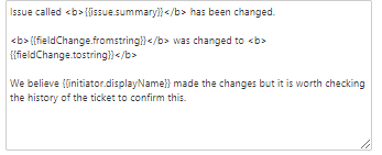

Hi,
I have set up an automation to send an email when a field is changed. I have managed to put in the email via smart value what the field was changed from and to, but is there a way to smart value import the actual field name itself.
The automation works by looking at 6 fields on an issue (there are 12 fields on the issue in total) and if one of those 6 changes then the email is sent.
Thanks

Thanks for the reply - i'm not quite sure I understand your reply. i currently have this set up such that when one of the values in the field listed change it shoots an email - I want one of the detail in the email to be 'what was the field that changed called?'

Have you tried {{fieldChange.field}} as that seems to work for me to give the name.
And...after the "new view" goes into effect, it'll only ever be one field at a time per edit by user (right?) so no need to worry about only the first change being captured in fieldChange, which is what happens today.

I can confirm this  worked for me as well
changed from [ {{fieldChange.fromString}} ] to [ {{fieldChange.toString}} ] by {{initiator.displayName}}
field name is {{fieldChange.field}}
