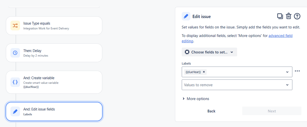

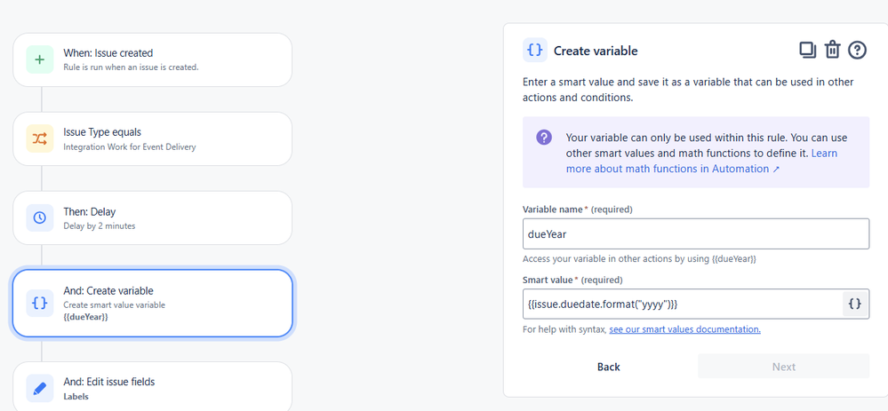

Hi everyone. I'm trying to create a smart value variable to use as part of an automation and I'm not sure why it's not working.
I want to add a label that shows the due date year when a particular kind of issue type is created. So for example if the due date is June 4, 2026, then a label that says "2026" would get added by the automation.
This is what I've set up:
And then:
But this what gets populated:
Can anyone tell me where I'm going wrong?
Thanks in advance for your help!
Bill Sheboy
December 13, 2024
Hi @Susan Merola
The Due Date field is a "date type" and Labels are text.  The date value must be formatted to be used as a label, as described here: https://support.atlassian.com/cloud-automation/docs/jira-smart-values-date-and-time/#Date-format---
For example, you could use this to get just the year value as text:
{{issue.duedate.format("yyyy")}}
Kind regards,
Bill

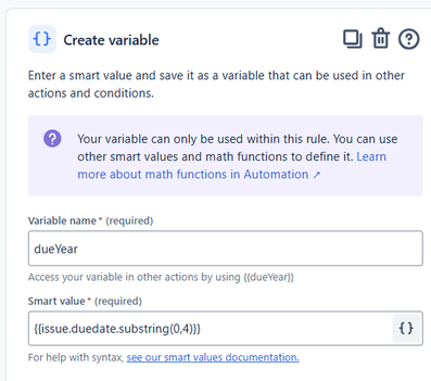

Susan Merola
December 18, 2024

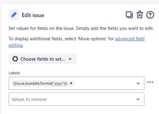

Hi Bill. Thanks for your reply.
Yes, I hadn't thought about that but it makes perfect sense. I've just tested out the string you shared and I got this:
So maybe there's some other step that I'm missing?  This is what my whole automation looks like:
Any guidance would be most welcome. Thanks!

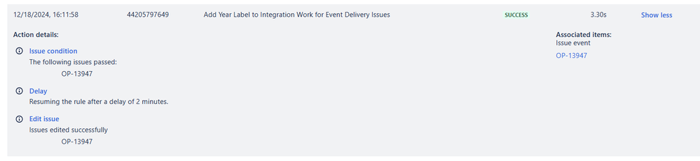

Would you please post images of your Edit Issue Fields action and of the audit log details showing the rule execution?  Thanks!
Susan Merola
December 18, 2024
Sure, thanks for the quick reply! Here's the Edit Issue action:
And here's the log entry:

Just wanted to let you know that I've just discovered that my problem was in the Edit Field. Putting the actual smart value there, instead of the variable name, solved the problem. Screenshot 2024-12-19 133058.png
