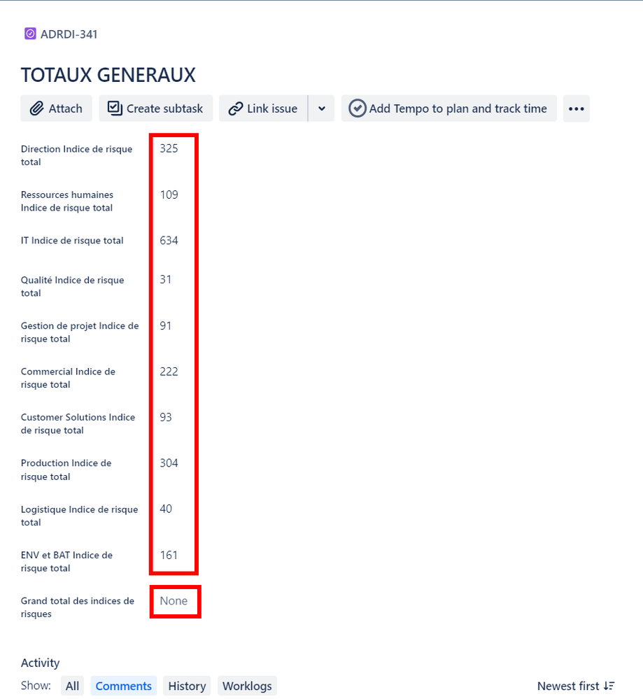

Hi Team,
I am trying to use automation to calculate a sum of several custom fields, whenever one of them is modified. Result of the sum should appear in "Grand total des indices de risques".
For some reason, I am not successful.
Here are my fields and automations so far :

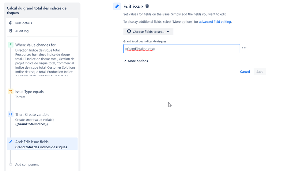

And my automations

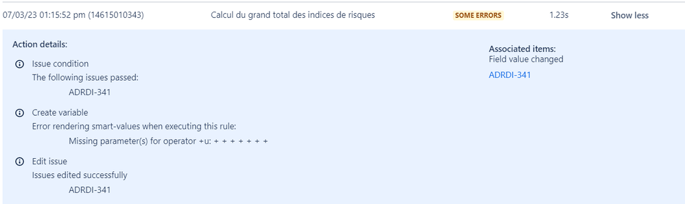

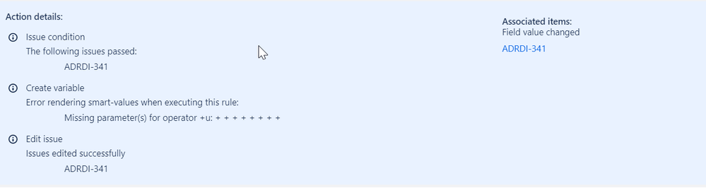

The error I get :

Looking at the image you posted of the Create Variable action, it appears there are some typos in your mathematical expression.
Some of the smart values start with
{{issue.fieldname.value}}
while others start with an extra character before "issue"
{{Iissue.fieldname.value}}
Please try removing those extra characters to see if that helps.

I also tried to reduce the string to 2 items and to insert an audit log, but here is what I got.
{{#=}} {{issue.Direction Indice de risque total.value}} } + {{issue.Qualité Indice de risque total.value}} {{/}}
