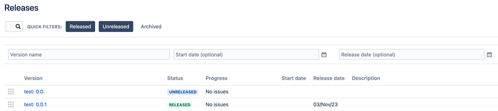

I have defined a rule to draft next release by incrementing the patching number by 1, the smart value I use is the following. I tested by releasing "test: 0.0.1", however it generate "test: 0.0.". Looks like asNumber does not work for me...

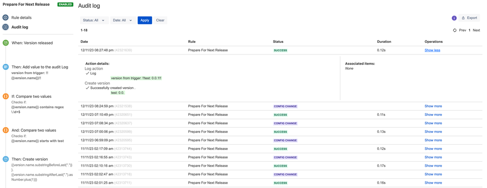

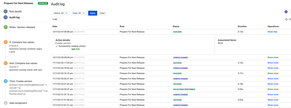

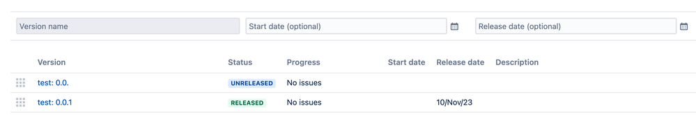

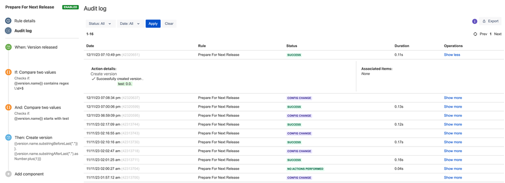

Zhengguan Li
November 12, 2023
It never works..but I can try disable and enable rules...
This is what I have after adding write to audit log...I guess it just does not work...

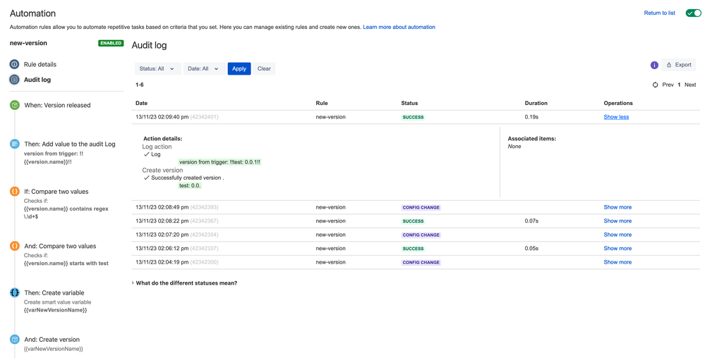

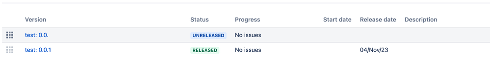

Zhengguan Li
November 13, 2023
Bill Sheboy
November 13, 2023
Would you please post an image of your Create Variable action?
Based on what your log is showing, that can be the only place remaining to explain this behavior.  When I tested with exactly the same version name and smart value expression, this worked for me with Jira Cloud's version of automation rules.
I saw you also posted "forget about it for now", so please disregard my request if you want to drop this one.  Thanks!

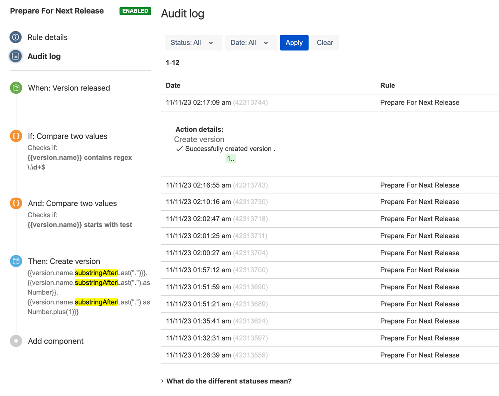

Zhengguan Li
November 12, 2023
This is the screenshot:image.pngimage.png
