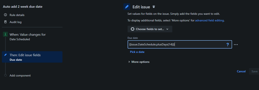

Hi everyone,
I'll looking for a smart value to auto create a due date 2 weeks from the date scheduled. Due Date is the system date but the Date scheduled is a custom field. For example, my team schedules a date with a customer. I have a rule that moves the task to pending deployment lane when the date scheduled value has been created. I would like to have the due date be auto created to show 2 weeks from the scheduled date.
Please let me know if that is possible.

Hi Trudy,
I tried this: {{issue.DateSchedule.plusDays(14)}}
It's not giving me creating the date but its also not showing that there is an error. In the log it's not showing there is an issue with the smart value.

Hello Alexis,
What is the name of the source field? Is it Date Scheduled (with a space) or DateScheduled (without a space)?
If you have not correctly identified the source field, the automation will not produce an error in this scenario.

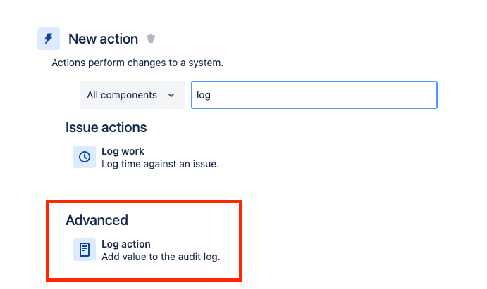

I'm not sure what you mean by add a log action, that only shows the time it takes for the rule to work correct? Date Scheduled is a custom date field.
Trudy P Claspill
January 25, 2023
Log is an Action that you can add to your rule.
https://support.atlassian.com/cloud-automation/docs/jira-automation-actions/#Log-action

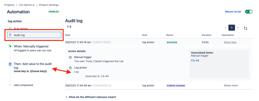

You can use it to add messages to the rule's Audit Log when a rule executes.
Click the Show More link to the right of an entry in the Audit Log to display the details for that entry.
