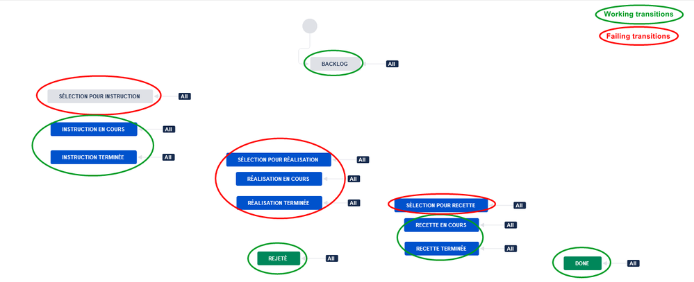

I'm having trouble using some transitions with smart commits.
It appears that issue is limited to transitions having accented characters at the beginning or in the middle of their names.
For example:
  • #recette-terminée => works OK
  • #réalisation-terminée => fails KO
To better explain the issue I'm facing here is a screen shot of the transitions I'm using:
I tried renaming the transition and removing the accented characters from their names but that didn't help.
I also tried using the transition name without accented character but with the same results.
Any help would be greatly appreciated.

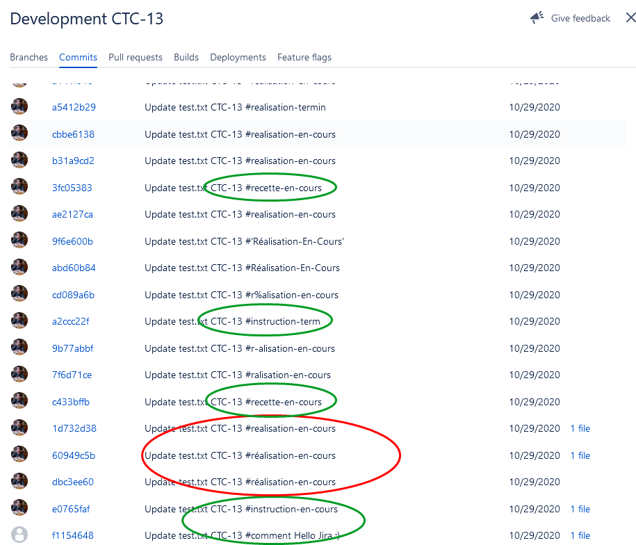

There is not much more to it, those are workflow transitions I'm trying to trigger using smart commits.
I'm not receiving any errors whatsoever.
We can see each message I tried to use on the issue all of them correctly displayed the accented characters: (once again the green ones worked and triggered the transition on the issue and the red one did not and this without any error)

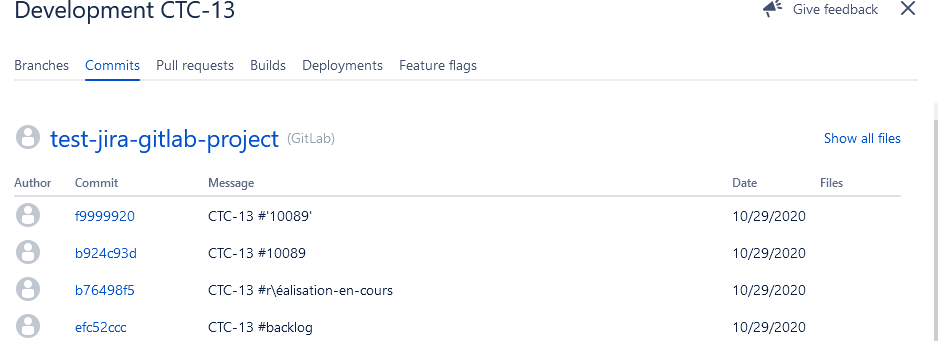

Do you have the status values in quotes? If so, you might try using the Status ID instead of the name.
Antoine Gauthier
October 29, 2020
No I don't have statuses values in quotes, I only tried sending them in quotes to see if that would help by any chance but sadly that did not.
I Just tried sending the Status ID quoted and unquoted: no luck there.
